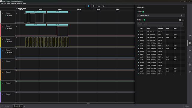

我搜到类似的问题,但没人解决。里面有一个链接引用,也不能访问了。只能再问一次
我想用CC2530读取CC1101的0x31寄存器(VERSION),但是逻辑分析仪的结果如下图,只返回状态码0x0F,但是不返回数据(预期0x14)
下面是CC2530的最小源文件

#define WR_OP_S(addr) ( (addr & 0x3f) | 0x00 ) // [7, 6] = 00
#define RD_OP_S(addr) ( (addr & 0x3f) | 0x80 ) // [7, 6] = 10

uchar SPI_send(uchar data){
U1DBUF = data; //write to send buffer
while(!(U1CSR & 0x01)); //wait for send(TX)
U1CSR &= ~0x01; //clear flag
return U1DBUF; //read receive, because SPI is full-duplex
uchar CC1101_ReadReg(uchar addr){
uchar value = 0x44;
CSn = 0; Delay(1);
SPI_send(RD_OP_S(addr));
value = SPI_send(0x00);
Delay(1); CSn = 1;
return value;
