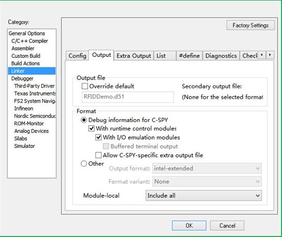

无法用IAR给CC2530的板子下载程序,而且SmartRF04EB仿真器也无法连通成功
Other Parts Discussed in Thread: CC2530, CC2530EM
Sat May 14 15:30:43 2016: Failed to load debugee: D:\毕设相关资料\ActiveRFID\资料\IAR固件源码\HOST_SLAVE_CODE\Projects\zstack\IAR_file\RFIDDemo\CC2530DB\RFIDHost\Exe\RFIDDemo.d51
这个是IAR窗口显示得的错误信息
然后在Linker的output选型里我也没发现什么异常啊,不懂是怎么回事?

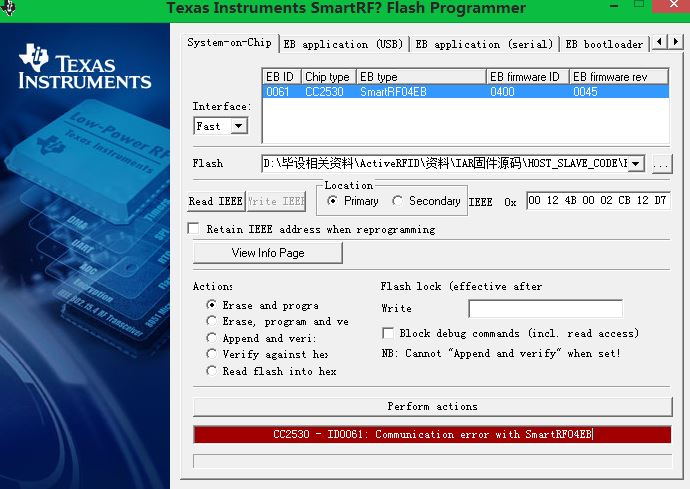

最后还有仿真器这儿也出问题了,如下图:
望各位大神能解囊相助,不胜感激。

  • http://www.ti.com/lit/an/swra280a/swra280a.pdf
    Will the SmartRF04EB boards work with the CC2530EM? o The CC2530 and CC2530EM modules represent the state of the art in TI’s IEEE 802.15.4 compliant System-On-Chip portfolio, and to keep up with the times we have focused our efforts on supporting state of the art tools including our newest SmartRF05EB development board. Unfortunately we have not included support for the older SmartRF04EB when developing for the CC2530, but the CC2530DK and CC2530ZDK come with all the necessary hardware so when you order a kit
    建议用SmartRF05EB或者CCdebugger连PC端SmartRF Studio,先能识别到
    http://www.ti.com/lit/ug/swru210a/swru210a.pdf?keyMatch=SmartRF05EB&tisearch=Search-EN-Everything
