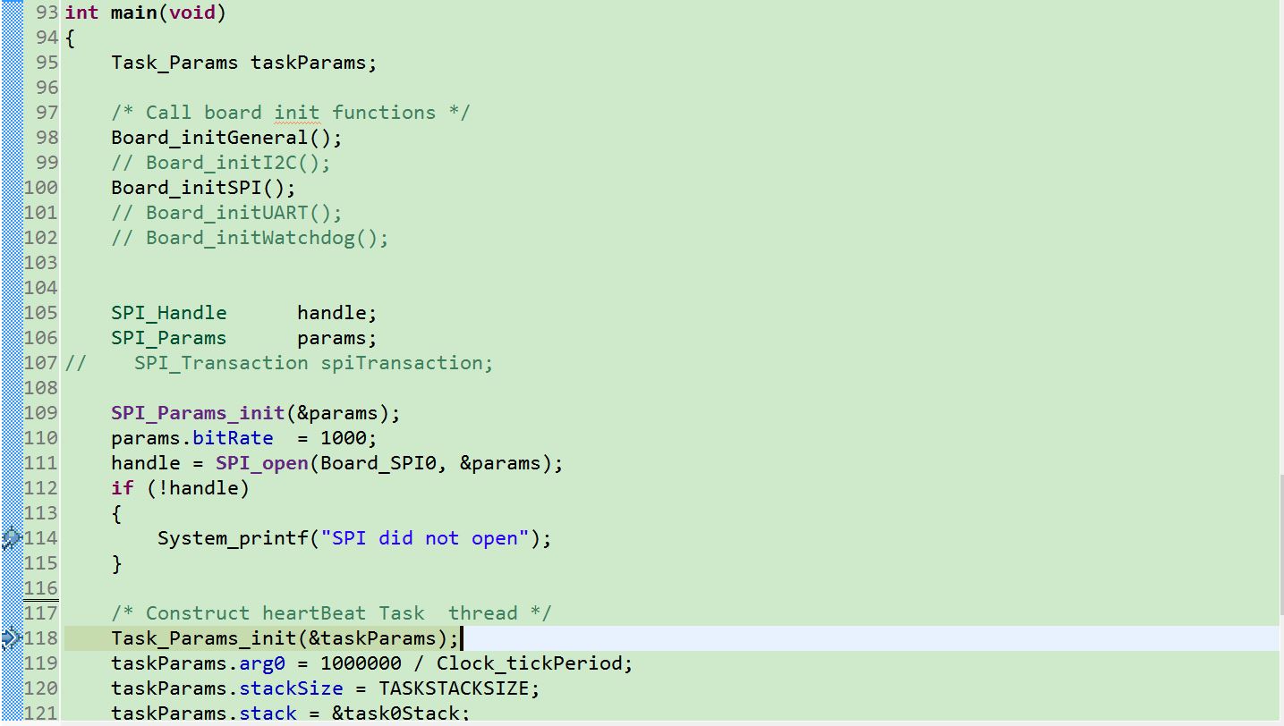

关于CC2650的SPI打开失败
协议栈自带的spi驱动,每次用图片的Spi_open() 函数,都打开失败,GREEN_LED闪烁,请问是什么 原因
  • 有没有先调用Board_initSPI();
    请看下面截图,程序能正常运行的。

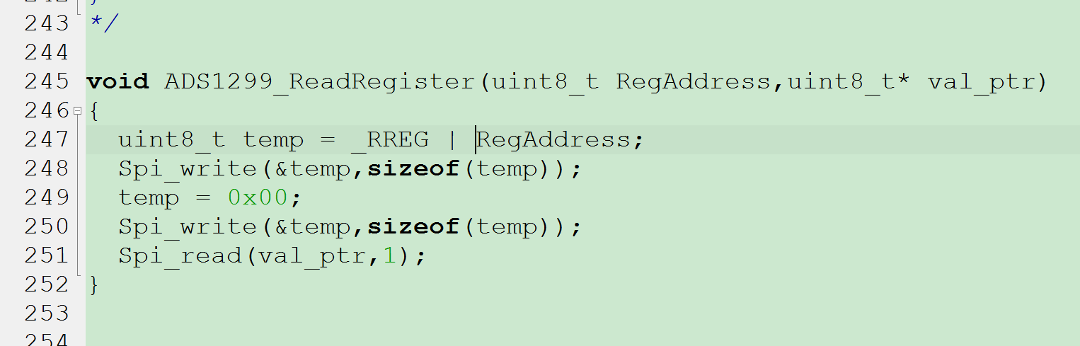

  • spi_open打开没有问题,但是我想读传感器的设备ID,总是读出的是0,图片里面的读写函数有问题吗?传感器片选一直是拉低的,并且已经power  on了,求解答
    _RREG是读寄存器的指令
    RegAddress是寄存器的地址
  • SPI数据传输的API是SPI_transfer(),请参考SPI.c和 SPI.h中的注释,了解具体使用方法。
    * ## Transferring data #
    * Data transmitted and received by the SPI peripheral is performed using
    * SPI_transfer(). SPI_transfer() accepts a pointer to a SPI_Transaction
    * structure that dictates what quantity of data is sent and received.
    * @code
    * SPI_Transaction spiTransaction;
    * spiTransaction.count = someIntegerValue;
    * spiTransaction.txBuf = transmitBufferPointer;
    * spiTransaction.rxBuf = receiveBufferPointer;
    * ret = SPI_transfer(handle, &spiTransaction);
    * if (!ret) {
    * System_printf("Unsuccessful SPI transfer");
    * @endcode
