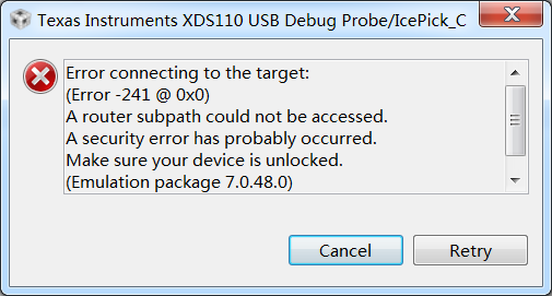

使用cc1310launchpad为其他cc1310芯片烧录时ccs连接不上
Other Parts Discussed in Thread: CC1310
断开了launchpad连接仿真器和板上cc1310的RXD TXD RESET TMS TCK TDI TDO SWO跳帽,将RESET TMS TCK TDI TDO SWO与另一块封装好的cc1310连接,在ccs中点击debug,弹出IcePick_C: Error connecting to the target: (Error -241 @ 0x0) A router subpath could not be accessed. A security error has probably occurred. Make sure your device is unlocked. (Emulation package 7.0.48.0) 如附件所示,但是on-chip flash需要连接上才能进行解锁或者擦除,目前无法连接上,所以无法在On-chip flash中进行解锁,请问这个问题应如何解决?
