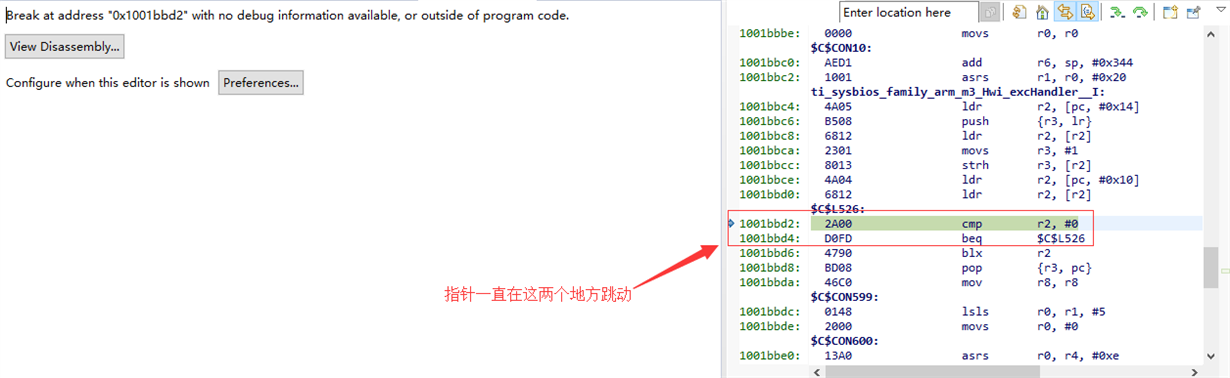

大家好
最近1310要低功耗,串口部分耗电比较多,我们这里串口不用的时候准备关闭串口,但是关闭串口后程序死机
串口初始化代码
    UART_init();
    UART_Params_init(&uart_params);
    uart_params.readMode = UART_MODE_CALLBACK;
    uart_params.readCallback = Uart_ReadCallback;
    uart_params.writeDataMode = UART_DATA_BINARY;
    uart_params.readDataMode = UART_DATA_BINARY;
    uart_params.readReturnMode = UART_RETURN_FULL;
    uart_params.readEcho = UART_ECHO_OFF;
    uart_params.baudRate = baudrate;
       uart0 = UART_open(Board_UART0, &uart_params);
        if (uart0 == NULL)
            System_abort("Error opening the UART");
串口关闭代码
    if(uart0 != NULL)
        UART_readCancel(uart0);
        UART_close(uart0);
        uart0 = NULL;
调试关闭串口后死机停止部分
谢谢各位了
