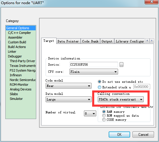

CC1110在IAR for 8051 (版本8.10.1)在线调试提示The stack 'XdataStack' is filled to 100% (1535 bytes used out of 1535). The warning threshold is set to 90.%

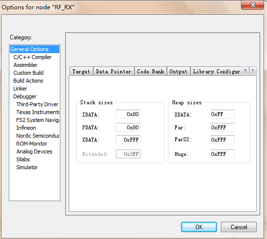

调试时 尝试增大Xdata STACK size 问题依旧;
百度谷歌有网友提示有数组或指针非法操作,单步调试下,cc1110复位,执行0x0000处的第一条跳转指令就提示如题的错误,
此时单片机没有任何的数据堆栈等的操作,但IAR IDE debug窗口依旧提示The stack 'XdataStack' is filled to 100% (1535 bytes used out of 1535). The warning threshold is set to 90.%
请问:有能给出建议的吗?
