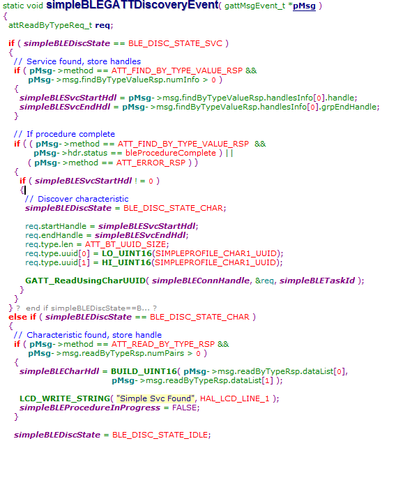

  • static void simpleBLEGATTDiscoveryEvent( gattMsgEvent_t *pMsg )
     attReadByTypeReq_t req;
     if ( simpleBLEDiscState == BLE_DISC_STATE_SVC )   {
     // Service found, store handles
     if ( pMsg->method == ATT_FIND_BY_TYPE_VALUE_RSP &&
       pMsg->msg.findByTypeValueRsp.numInfo > 0 )
        simpleBLESvcStartHdl = pMsg->msg.findByTypeValueRsp.handlesInfo[0].handle;
        simpleBLESvcEndHdl = pMsg->msg.findByTypeValueRsp.handlesInfo[0].grpEndHandle;
     // If procedure complete
     if ( ( pMsg->method == ATT_FIND_BY_TYPE_VALUE_RSP  &&
     pMsg->hdr.status == bleProcedureComplete ) ||
     ( pMsg->method == ATT_ERROR_RSP ) )
    if ( simpleBLESvcStartHdl != 0 )
    // Discover characteristic
      simpleBLEDiscState = BLE_DISC_STATE_CHAR;
         req.startHandle = simpleBLESvcStartHdl;
         req.endHandle = simpleBLESvcEndHdl;
         req.type.len = ATT_BT_UUID_SIZE;
      req.type.uuid[0] = LO_UINT16(SIMPLEPROFILE_CHAR1_UUID);
         req.type.uuid[1] = HI_UINT16(SIMPLEPROFILE_CHAR1_UUID);
       GATT_ReadUsingCharUUID( simpleBLEConnHandle, &req, simpleBLETaskId );
    else if ( simpleBLEDiscState == BLE_DISC_STATE_CHAR )
     // Characteristic found, store handle
     if ( pMsg->method == ATT_READ_BY_TYPE_RSP &&
        pMsg->msg.readByTypeRsp.numPairs > 0 )
           simpleBLECharHdl[0] = BUILD_UINT16( pMsg->msg.readByTypeRsp.dataList[0],
           pMsg->msg.readByTypeRsp.dataList[1] );
               LCD_WRITE_STRING( "Simple Svc Found", HAL_LCD_LINE_1 );
                simpleBLEProcedureInProgress = TRUE;
               //simpleBLEProcedureInProgress = FALSE;
                simpleBLEDiscState = BLE_DISC_STATE_CHAR2;
                //simpleBLEDiscState = BLE_DISC_STATE_IDLE;
                req.type.uuid[0] = LO_UINT16(SIMPLEPROFILE_CHAR2_UUID);
               req.type.uuid[1] = HI_UINT16(SIMPLEPROFILE_CHAR2_UUID);
            else if (simpleBLEDiscState == BLE_DISC_STATE_CHAR2)
              {     // Characteristic found, store handle
                 //if ( pMsg->method == ATT_READ_BY_TYPE_RSP &&
                //    pMsg->msg.readByTypeRsp.numPairs > 0 )
                simpleBLECharHdl[1] = BUILD_UINT16( pMsg->msg.readByTypeRsp.dataList[0],
    这样改后,Central能不断的读到Peripheral Char1的数据,但是读不到Char2的数据,   simpleBLECharHdl[1]句柄的值一直为0。
  • 在连接成功后,通过下面方式请求读取Peripheral的前两个Char的值
          for(int i = 0; i < 2; i++)
          attReadReq_t req;
          if(simpleBLECharHdl[i]  !=  0)
               req.handle = simpleBLECharHdl[i];
               status = GATT_ReadCharValue( simpleBLEConnHandle, &req, simpleBLETaskId );
              if ( status == SUCCESS )
              //simpleBLEDoWrite = !simpleBLEDoWrite;
    但是没有办法同时读取Peripheral的前两个Char的值。我现在只想Central能够通过定时查询的方式,读取Peripheral的Char1和Char2的值。
    现在Peripheral Char1是可读可写,Char2是只读的。
    如果单独定时去读的话,Char1和Char2的值能读出来。

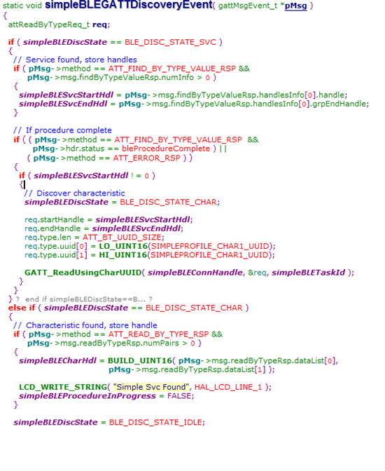

  • 你试一下下面的代码, 注意红色部分:
    //LCD_WRITE_STRING( "Simple Svc Found", HAL_LCD_LINE_1 );
     // . 这里加"else", 目的为了判断pMsg->msg.readByTypeRsp.numPairs 是否为 0.  因为client 会一直查找到返回handle 为0 为止, 有可能因为设计需要, 同一个
                  service 里面会有两个以上相同的characteristic 定义. 只有等 char1 被查完了, 你再去发起查找char2 的流程.
    else
    // 这个判断打开, 理由同上.
  • 至少我这边用这样是没问题, 两个handle 都能得到.
