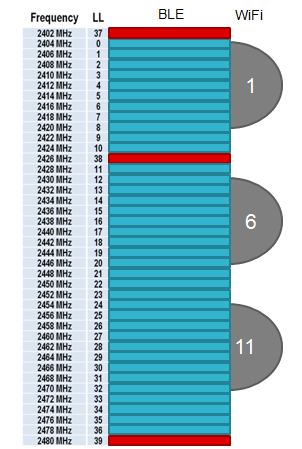

    Bluetooth low energy operates in the unlicensed 2.4 GHz band together with WiFi, Bluetooth Classic, Zigbee and others. Bluetooth low energy uses 40 Radio Frequency channels. There are two types of BLE channels: advertising and data channels. Advertising is done on three physical channels, shown in red. These channels have been chosen to minimize overlap with the most commonly used WiFi channels (as shown in the figure).
    The advertising channels are used to discover devices, establish connections and for broadcasting messages, whereas data channels are used for bidirectional communication between connected devices.
    A frequency hopping mechanism is used in order to avoid possible interference and wireless propagation issues, such as fading and multipath.
