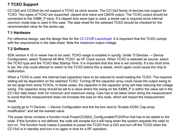

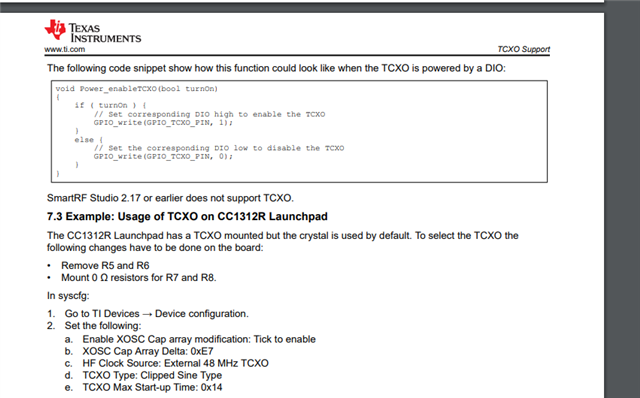

Did you follow my instructions from the previous thread? (+) CC1312R: TCXO issue - Sub-1 GHz forum - Sub-1 GHz - TI E2E support forums
With those modifications, the device is going into standby mode:
Can you tell me why you think the device is not going into standby mode?
