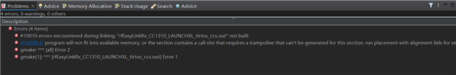

CC1310: 编译报错#10099-D,请问产生的原因和解决方法?
Part Number: CC1310

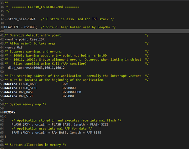

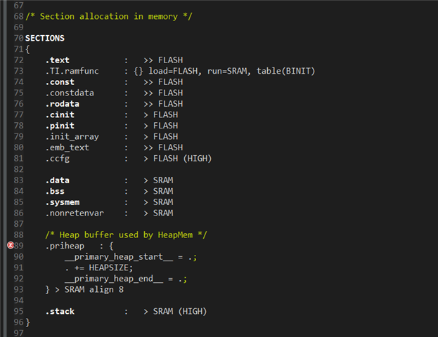

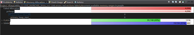

是因为sram空间不够导致的吗?请问如何解决?
报错如下:#10099-D: program will not fit into available memory, or the section contains a call site that requires a trampoline that can't be generated for this section. run placement with alignment fails for section ".priheap" size 0x1000.  Available memory ranges: CC1310_LAUNCHXL_TIRTOS.cmd /rfEasyLinkRx_CC1310_LAUNCHXL_tirtos_ccs line 89 C/C++ Problem
