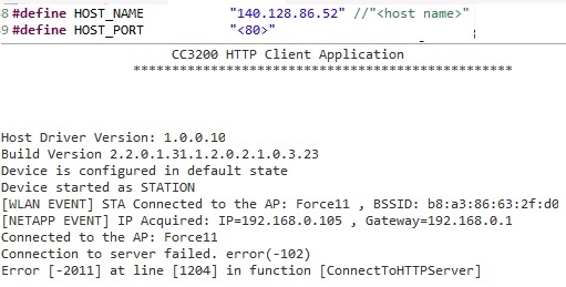

我嘗試著要練習這個範例
但是常是連上IP或者網址
都會出現錯誤
我有哪裡沒設定好嗎?

可以尝试改一下端口号。

你好,
我尝试ping140.128.86.52
Pinging 140.128.86.52 with 32 bytes of data:
Request timed out.
Request timed out.
Request timed out.
Request timed out.
Ping statistics for 140.128.86.52:
Packets: Sent = 4, Received = 0, Lost = 4 (100% loss),
应该是服务器的问题。
