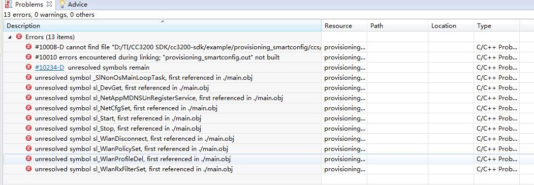

本人想试下smartconfig功能,在build provisioning_smartconfig过程中,编译出现了如下错误,不知道该怎么解决,请大家帮我看一下。谢谢!
<Linking>
error #10008-D: cannot find file "D:/TI/CC3200 SDK/cc3200-sdk/example/provisioning_smartconfig/ccs/../../../simplelink/ccs/NON_OS/simplelink.a"
undefined first referenced
symbol in file
_SlNonOsMainLoopTask ./main.obj
sl_DevGet ./main.obj
sl_NetAppMDNSUnRegisterService ./main.obj
sl_NetCfgSet ./main.obj
sl_Start ./main.obj
sl_Stop ./main.obj
sl_WlanDisconnect ./main.obj
sl_WlanPolicySet ./main.obj
sl_WlanProfileDel ./main.obj
sl_WlanRxFilterSet ./main.obj
sl_WlanSet ./main.obj
>> Compilation failure
sl_WlanSetMode ./main.obj
sl_WlanSmartConfigStart ./main.obj
error #10234-D: unresolved symbols remain
error #10010: errors encountered during linking; "provisioning_smartconfig.out" not built
gmake: *** [provisioning_smartconfig.out] Error 1
gmake: Target `all' not remade because of errors.
