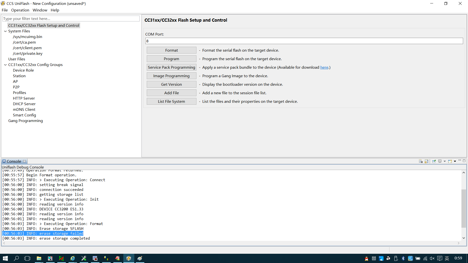

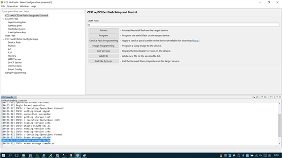

CC3200自己做得板子,调试一切wlan之外的例程一切正常,用uniflash format始终不成功,sdk1.2.0 !
Other Parts Discussed in Thread: CC3200, CC3100
  • 板子上的flash芯片用的是否TI推荐型号?
  • 另外查下flash芯片的供电是否正常
  • 用的参考设计上的型号:M25PX80,   供电3.4V左右,电路完全是按照参考设计,今天测了下,CC3200 42脚没有电压。
  • [15:36:41] Begin Format operation.
    [15:36:42] INFO: > Executing Operation: Connect
    [15:36:42] DEBUG: waiting and clearing uart rx buffer
    [15:36:44] INFO: setting break signal
    [15:36:44] DEBUG: wait for ack
    [15:36:45] DEBUG: UART timeout
    [15:36:45] DEBUG: --- COM Port timeout on ACK read
    [15:36:45] INFO: detecting FTDI for device reset
    [15:36:45] DEBUG: got 2 devices connected
    [15:36:45] DEBUG: Device 0: , SN:
    [15:36:45] DEBUG: Device 1: USB <-> JTAG/SWD A , SN: ccZAG30BA
    [15:36:45] ERROR: No device USB ports were found
    [15:36:45] INFO: --- please restart the device ---
    [15:36:45] DEBUG: wait for ack
    [15:37:00] DEBUG: UART timeout
    [15:37:00] DEBUG: --- COM Port timeout on ACK read
    [15:37:00] ERROR: ---reading ACK signal failed---
    [15:37:00] DEBUG: disconnecting from device . . .
    [15:37:00] WARNING: ---seting break signal to false failed---
    [15:37:00] DEBUG: --- Connection failed trying to reconnect... (1 attempt)
    [15:37:00] DEBUG: waiting and clearing uart rx buffer
    [15:37:02] INFO: setting break signal
    [15:37:02] DEBUG: wait for ack
    [15:37:03] INFO: connection succeeded
    [15:37:03] INFO: getting storage list
    [15:37:03] DEBUG: wait for ack
    [15:37:03] INFO: > Executing Operation: Init
    [15:37:03] INFO: reading version info
    [15:37:03] INFO: DEVICE CC3200 ES1.33
    [15:37:03] DEBUG: Bootloader version is 2, 1, 4, 0
    [15:37:03] DEBUG: It's a CC3200 device: PG1.33 or higher
    [15:37:03] DEBUG: Switch UART pinmux to APPS
    [15:37:04] DEBUG: Switch to NWP bootloader complete
    [15:37:04] INFO: reading version info
    [15:37:04] DEBUG: wait for ack
    [15:37:04] DEBUG: Bootloader version is 2, 0, 4, 0
    [15:37:04] DEBUG: raw storage write
    [15:37:04] DEBUG: status request
    [15:37:04] DEBUG: BlockSize is 4096, number of blocks is 16
    [15:37:04] DEBUG: erasing 13 blocks starting from 0
    [15:37:05] DEBUG: wait for ack
    [15:37:05] DEBUG: status request
    [15:37:06] DEBUG: status request
    [15:37:06] DEBUG: wait for ack
    [15:37:06] DEBUG: 0
    [15:37:06] INFO: > Executing Operation: Format
    [15:37:06] INFO: Erase storage SFLASH
    [15:37:06] DEBUG: Error -20 : Unknown command
    [15:37:06] INFO: erase storage failed
    [15:37:06] INFO: erase storage completed
    [15:37:06] INFO: > Executing Operation: Disconnect
    [15:37:06] DEBUG: disconnecting from device . . .
    [15:37:06] Operation Format returned.
