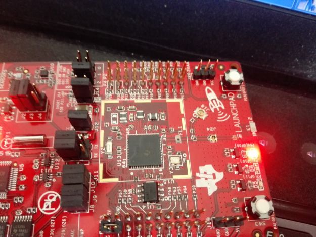

开发板需要注意的是:
安装完开发环境,去app center 安装cc3200相关资源;

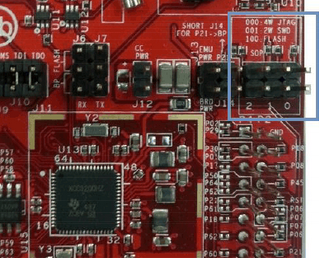

如果需要在线仿真,需要短接JTAG引脚,即用短路帽连接;
方框处的模式选择,如果下载,连接2处;

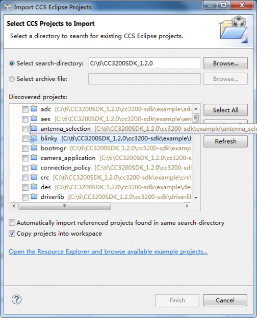

打开软件导入Blinky工程;
文件路径选择,cc3200sdk安装目录,可以看到有很多工程,选择,Blinky工程,默认会拷贝到workspace下,

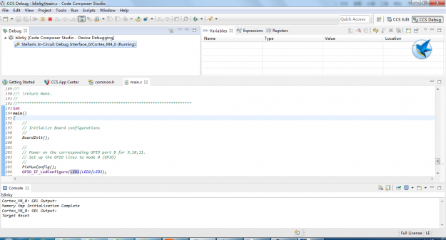

编译工程,运行调试工程,会发现LED灯切换闪烁。

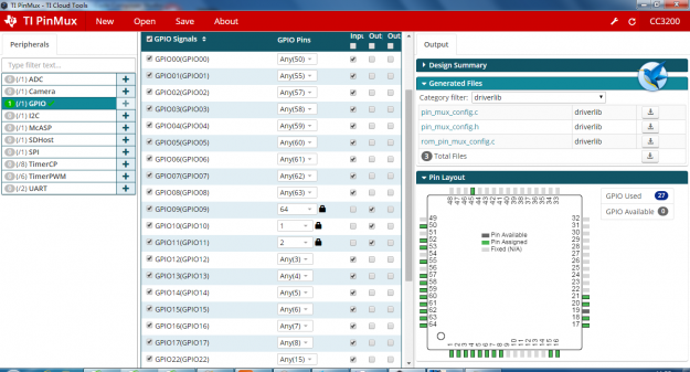

管教配置如上图所示,可生成配置文件。
使能时钟
  MAP_PRCMPeripheralClkEnable(PRCM_GPIOA1, PRCM_RUN_MODE_CLK);
设置led对应的管教,out模式,
    // Configure PIN_64 for GPIOOutput
    MAP_PinTypeGPIO(PIN_64, PIN_MODE_0, false);
    MAP_GPIODirModeSet(GPIOA1_BASE, 0x2, GPIO_DIR_MODE_OUT);
    // Configure PIN_01 for GPIOOutput
    MAP_PinTypeGPIO(PIN_01, PIN_MODE_0, false);
    MAP_GPIODirModeSet(GPIOA1_BASE, 0x4, GPIO_DIR_MODE_OUT);
    // Configure PIN_02 for GPIOOutput
    MAP_PinTypeGPIO(PIN_02, PIN_MODE_0, false);
    MAP_GPIODirModeSet(GPIOA1_BASE, 0x8, GPIO_DIR_MODE_OUT);

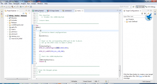

主函数如下
int
main()
    // Initialize Board configurations
    BoardInit();
    // Power on the corresponding GPIO port B for 9,10,11.
    // Set up the GPIO lines to mode 0 (GPIO)
    PinMuxConfig();
    GPIO_IF_LedConfigure(LED1|LED2|LED3);
    GPIO_IF_LedOff(MCU_ALL_LED_IND);
    // Start the LEDBlinkyRoutine
    LEDBlinkyRoutine();
    return 0;
