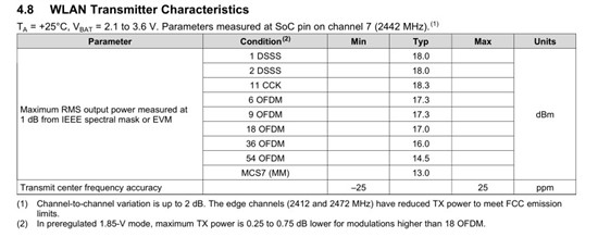

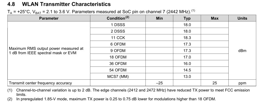

   基于 SimpleLink 如何配置 cc3200 的TX power 啊? wlan.h 里的描述如下
#define WLAN_GENERAL_PARAM_OPT_STA_TX_POWER  (10)
 - <b>WLAN_GENERAL_PARAM_OPT_STA_TX_POWER</b> \n
                                      Set STA mode Tx power level \n
                                      Number between 0-15, as dB offset from max power (0 will set MAX power) \n
                                      This options takes <b>_u8</b> as parameter
请问 max power 是多少?
默认WLAN_GENERAL_PARAM_OPT_STA_TX_POWER  等于10的情况下, tx power是多少db?
