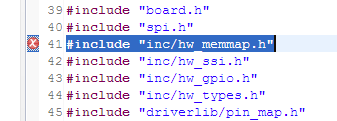

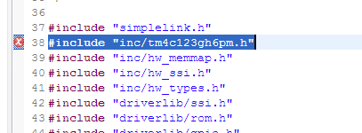

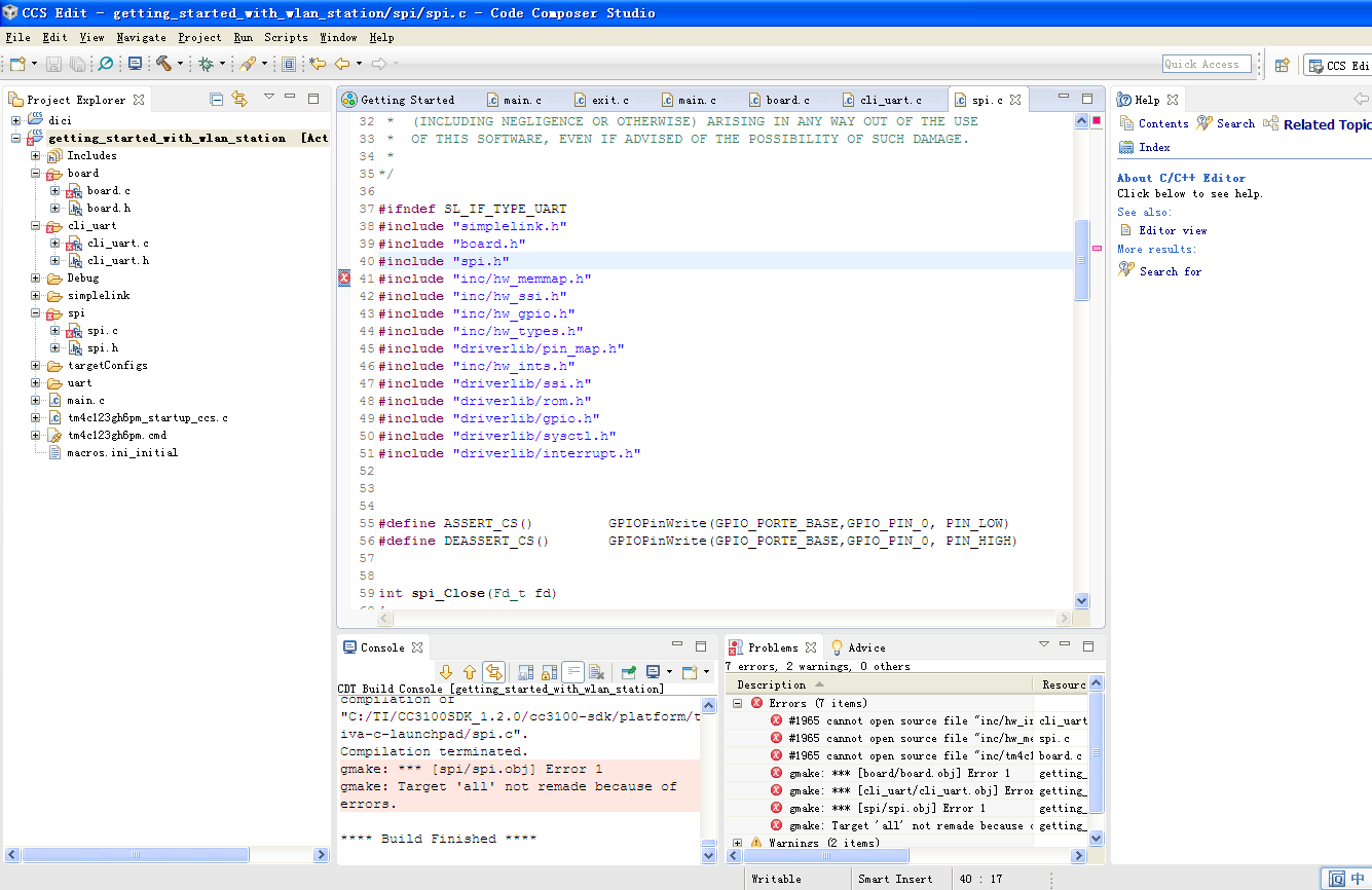

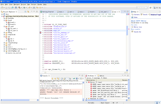

关于CC3100+CC3100EMUBOOST+MSP430F5529,运行最后出错
  • 从图片中看到错误信息是编译器在编译过程中未找到该路径的文件,首先确认在CCS的设置的地址引用中,该地址索引下是否有对应的文件,如果没有需要添加,或者修改CCS在该地址的索引,
    关于CCS的一些基本使用参考如下:
    ①在工程属性中 Linked Resources-> Path Variables中添加
    <1>Name:CC3200_SDK_ROOT Value:${ORIGINAL_PROJECT_ROOT}\..\..\..
    同时注意下Resolved Location地址是否正确!
    <2>Name:ORIGINAL_PROJECT_ROOT Value:C:\ti\CC3200SDK_1.1.0\cc3200-sdk\example\blinky\ccs
    ①ARM-Compiler->Include Options
    注:实际CC3200_SDK_ROOT指向 C:\ti\CC3200SDK_1.1.0\cc3200-sdk
    "${CG_TOOL_ROOT}/include"
    "${CC3200_SDK_ROOT}/simplelink/"
    "${CC3200_SDK_ROOT}/simplelink/include"
    "${CC3200_SDK_ROOT}/simplelink/source"
    "${CC3200_SDK_ROOT}/example/common"
    "${CC3200_SDK_ROOT}/driverlib"
    "${CC3200_SDK_ROOT}/inc"
    ②ARM-Linker->File Search Path
    "libc.a"
    "${CC3200_SDK_ROOT}/simplelink/ccs/NON_OS/simplelink.a"
    "${CC3200_SDK_ROOT}/driverlib/ccs/Release/driverlib.a"
    Addition:
    <1>ARM-Compiler->Advanced options->Predefined Symbols 在Pre-define NAME添加:
    ccs
    USER_INPUT_ENABLE
    cc3200
    <3>默认情况下,通过CCS编译的工程,只生成.out文件。需要通过工程配置,添加必要的语句,编译后生成bin文件(也叫post build)
    在Build->Steps->Post-build steps下添加:
    "${CCE_INSTALL_ROOT}/utils/tiobj2bin/tiobj2bin" "${BuildArtifactFileName}" "${BuildArtifactFileBaseName}.bin" "${CG_TOOL_ROOT}/bin/armofd" "${CG_TOOL_ROOT}/bin/armhex" "${CCE_INSTALL_ROOT}/utils/tiobj2bin/mkhex4bin"
    然后Rebuild All就可以在Debug/Release下生成.bin文件了
