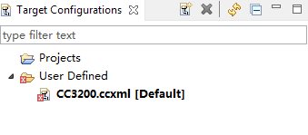

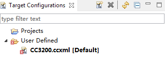

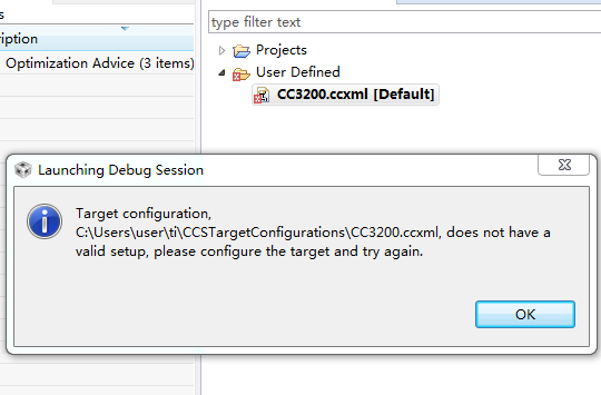

在 目标配置时,导入目标配置文件cc3200.ccxml,复制文件,一复制过来文件上就有一个红叉,也不能调试
  • http://www.ti.com/lit/ug/swru369c/swru369c.pdf
    配置方式按照上面的编程向导来的吗?
    另外用下面的代码试试看。
    <?xml version="1.0" encoding="UTF-8" standalone="no"?>
    <configurations XML_version="1.2" id="configurations_0">
    <configuration XML_version="1.2" id="Stellaris In-Circuit Debug Interface_0">
    <instance XML_version="1.2" desc="Stellaris In-Circuit Debug Interface_0" href="connections/Stellaris_ICDI_Connection.xml" id="Stellaris In-Circuit Debug Interface_0" xml="Stellaris_ICDI_Connection.xml" xmlpath="connections"/>
    <connection XML_version="1.2" id="Stellaris In-Circuit Debug Interface_0">
    <instance XML_version="1.2" href="drivers/stellaris_cs_icepick.xml" id="drivers" xml="stellaris_cs_icepick.xml" xmlpath="drivers"/>
    <instance XML_version="1.2" href="drivers/stellaris_cs_dap.xml" id="drivers" xml="stellaris_cs_dap.xml" xmlpath="drivers"/>
    <instance XML_version="1.2" href="drivers/stellaris_cortex_m4.xml" id="drivers" xml="stellaris_cortex_m4.xml" xmlpath="drivers"/>
    <platform XML_version="1.2" id="platform_0">
    <instance XML_version="1.2" desc="CC3200_0" href="devices/CC3200.xml" id="CC3200_0" xml="CC3200.xml" xmlpath="devices"/>
    </platform>
    </connection>
    </configuration>
    </configurations>
  • 不行,还是老样子,我不想重新装CCS啊
  • 你用的CC3200的板子是TI的luanchpad吗?版本是多少,如果是4.0以上的,就可以用C:\ti\CC3200SDK_1.2.0\cc3200-sdk\tools\ccs_patch\CC3200.ccxml
