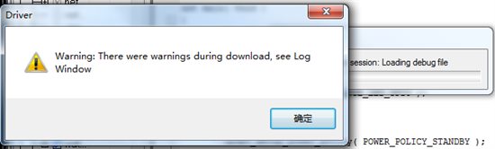

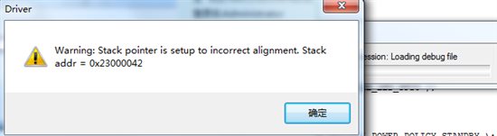

Attaching J-Link Script to a IAR Project
  • Open Project->Options->Debugger and select J-Link/J-Trace from the Driver drop down.
  • Press OK.
  • Start the debug session by pressing “Download and Debug” session button.
  • This debug session will fail to connect to target.
  • Click the J-Link icon from notification area on task bar to open up the J-Link Control Panel
  • Go to ‘Setting’ tab and select the script file to execute.
  • Close the control panel.
  • On IAR, terminate the debug session and restart the session.
