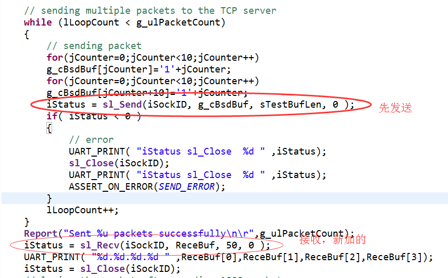

      cc3200一直为客户端,发送数据后接收服务器回传的数据,我在int BsdTcpClient(unsigned short usPort)程序中加了接收语句。

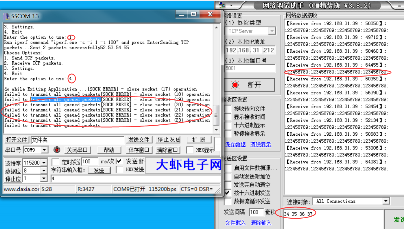

CC32串口有时给我发送提示
[SOCK ERROR] - close socket (17) operation failed to transmit all queued packets
[SOCK ERROR] - close socket (18) operation failed to transmit all queued packets
如下图,为什么会有这样的提示?
