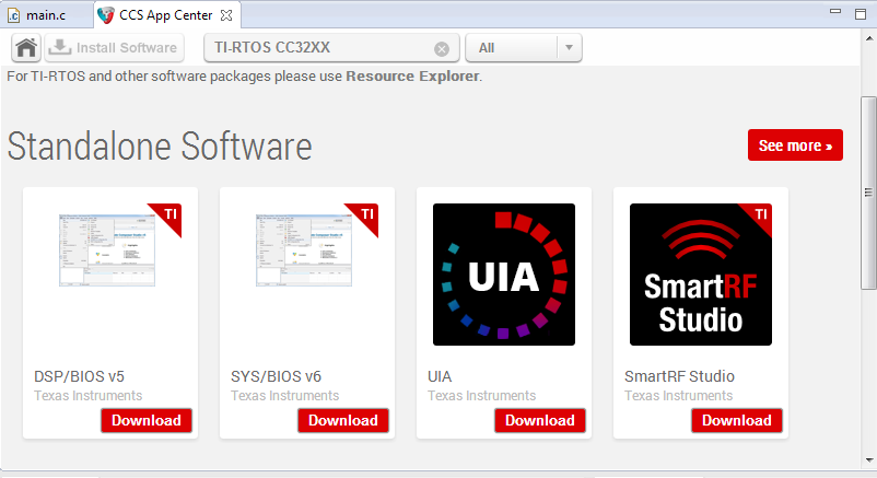

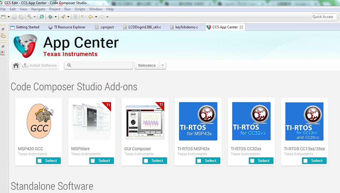

CCS 遇到困难 求各路大神指导
Other Parts Discussed in Thread: CC3200, SYSBIOS
我安装的ccs  v6  为什么没有 TI-RTOS CC32XX”组件的下载 ,直接没有这一项  为什么     求各路大神知道一下
CC32xx TI-RTOS

Using TI-RTOS with CC32xx SDK
TI-RTOS for CC3xxx 2.01.00.03 has been used with CC3200 applications.
It can be installed from the link from the app center of CCS v6.0.1
