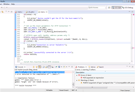

版本为1.2.0和1.1.0中的案例都尝试编译都失败了。理论上我没有对案例中程序进行修改,inport后直接编译的。报错如下:
"../main.c", line 940: error #29: expected an expression

  • 您好,根据您的回答,在前面定义了
    #define HOST_PORT              80
    语句:
    addr.sin_port = htons(HOST_PORT);
    就通过了。
    原来定义的是:
    #define HOST_PORT              <80>
    新的问题错误如下:

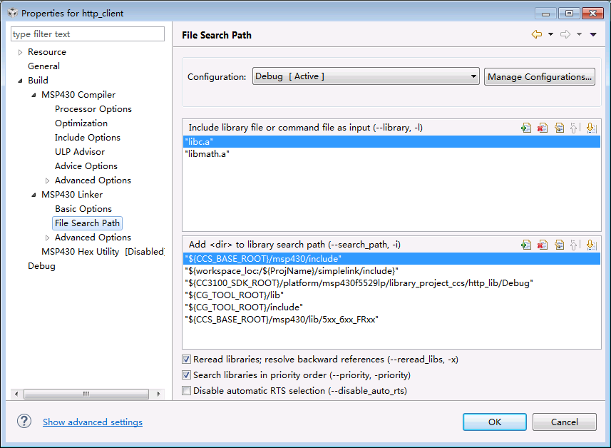

    'Building target: http_client.out'
    'Invoking: MSP430 Linker'
    "D:/TI/ccsv6/tools/compiler/ti-cgt-msp430_4.4.5/bin/cl430" -vmspx --abi=eabi --data_model=restricted -g --define=__MSP430F5529__ --define=__SL__ --define=__CCS__ --define=_USE_CLI_ --diag_warning=225 --display_error_number --diag_wrap=off --silicon_errata=CPU21 --silicon_errata=CPU22 --silicon_errata=CPU23 --silicon_errata=CPU40 --printf_support=full -z -m"http_client.map" --heap_size=500 --stack_size=500 --use_hw_mpy=F5 --cinit_hold_wdt=on -i"D:/TI/ccsv6/ccs_base/msp430/include" -i"D:/TI/http_client/simplelink/include" -i"D:/TI/CC3100SDK_1.2.0/cc3100-sdk/platform/msp430f5529lp/library_project_ccs/http_lib/Debug" -i"D:/TI/ccsv6/tools/compiler/ti-cgt-msp430_4.4.5/lib" -i"D:/TI/ccsv6/tools/compiler/ti-cgt-msp430_4.4.5/include" -i"D:/TI/ccsv6/ccs_base/msp430/lib/5xx_6xx_FRxx" --reread_libs --priority --warn_sections --display_error_number --diag_wrap=off --xml_link_info="http_client_linkInfo.xml" --rom_model -o "http_client.out" "./jsmn.obj" "./main.obj" "./spi/spi.obj" "./simplelink/source/device.obj" "./simplelink/source/driver.obj" "./simplelink/source/flowcont.obj" "./simplelink/source/fs.obj" "./simplelink/source/netapp.obj" "./simplelink/source/netcfg.obj" "./simplelink/source/nonos.obj" "./simplelink/source/socket.obj" "./simplelink/source/spawn.obj" "./simplelink/source/wlan.obj" "./cli_uart/cli_uart.obj" "./board/board.obj" "../lnk_msp430f5529.cmd" -l"libc.a" -l"libmath.a"
    <Linking>
    undefined first referenced
    symbol in file
    HTTPCli_connect ./main.obj
    HTTPCli_construct ./main.obj
    HTTPCli_getResponseField ./main.obj
    HTTPCli_getResponseStatus ./main.obj
    HTTPCli_readResponseBody ./main.obj
    HTTPCli_sendField ./main.obj
    HTTPCli_sendRequest ./main.obj
    HTTPCli_sendRequestBody ./main.obj
    HTTPCli_setRequestFields ./main.obj
    HTTPCli_setResponseFields ./main.obj
    error #10234-D: unresolved symbols remain
    error #10010: errors encountered during linking; "http_client.out" not built

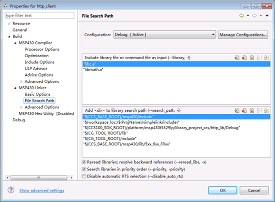

    以下是我的Linker的截图:
