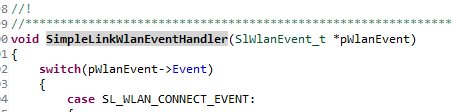

关于下面这些handler函数,历程中在哪里调用??
比如:
找不到代码中有调用他的地方,希望知道的人指教一下~~
  • 关于SimpleLinkWlanEventHandler()函数的目的是,当CC3200的NWP内核连接到WLan后,会通过内部SPI的总线通知CC3200的M4内核,进行Callback函数的回调处理,这个Handler函数就是其中之一的回调函数
    // SimpleLink Asynchronous Event Handlers -- Start
    //! \brief The Function Handles WLAN Events
    //! \param[in] pWlanEvent - Pointer to WLAN Event Info
    //! \return None
    void SimpleLinkWlanEventHandler(SlWlanEvent_t *pWlanEvent)
    if(pWlanEvent == NULL)
    UART_PRINT("Null pointer\n\r");
    LOOP_FOREVER();
    switch(pWlanEvent->Event)
    case SL_WLAN_CONNECT_EVENT:
    SET_STATUS_BIT(g_ulStatus, STATUS_BIT_CONNECTION);
    // Information about the connected AP (like name, MAC etc) will be
    // available in 'slWlanConnectAsyncResponse_t'
    // Applications can use it if required
    // slWlanConnectAsyncResponse_t *pEventData = NULL;
    // pEventData = &pWlanEvent->EventData.STAandP2PModeWlanConnected;
    // Copy new connection SSID and BSSID to global parameters
    memcpy(g_ucConnectionSSID,pWlanEvent->EventData.
    STAandP2PModeWlanConnected.ssid_name,
    pWlanEvent->EventData.STAandP2PModeWlanConnected.ssid_len);
    memcpy(g_ucConnectionBSSID,
    pWlanEvent->EventData.STAandP2PModeWlanConnected.bssid,
    SL_BSSID_LENGTH);
    UART_PRINT("[WLAN EVENT] STA Connected to the AP: %s , "
    "BSSID: %x:%x:%x:%x:%x:%x\n\r",
    g_ucConnectionSSID,g_ucConnectionBSSID[0],
    g_ucConnectionBSSID[1],g_ucConnectionBSSID[2],
    g_ucConnectionBSSID[3],g_ucConnectionBSSID[4],
    g_ucConnectionBSSID[5]);
    break;
