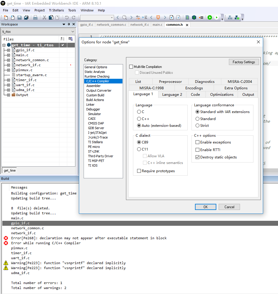

只修改了common.h里的SSID和密码,其余设置均为默认值

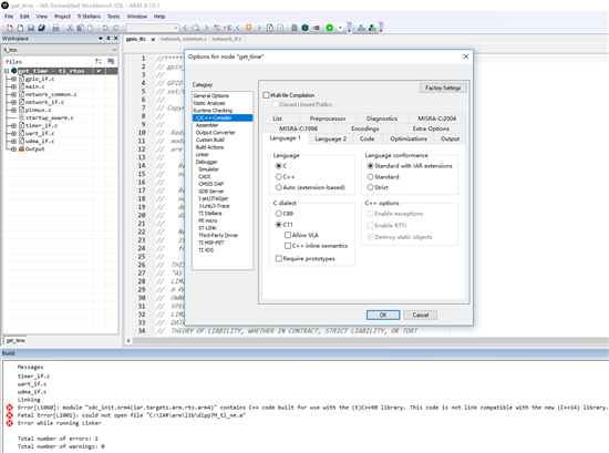

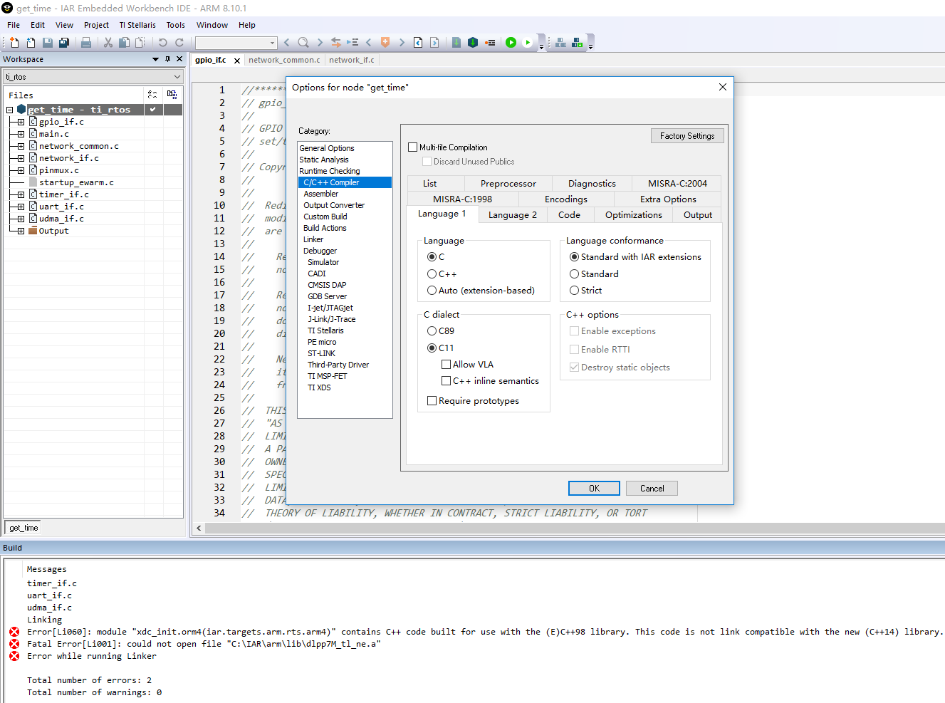

如下图所示,在链接时出现错误信息:
Error[Li060]: module "xdc_init.orm4(iar.targets.arm.rts.arm4)" contains C++ code built for use with the (E)C++98 library. This code is not link compatible with the new (C++14) library.
我尝试过把C/C++编译器改为C89,却得到了如下的错误信息:
Error[Pe268]: declaration may not appear after executable statement in block C:\TI\CC3200SDK_1.3.0\cc3200-sdk\example\common\network_if.c 427
Error while running C/C++ Compiler
Warning[Pe223]: function "vsnprintf" declared implicitly C:\TI\CC3200SDK_1.3.0\cc3200-sdk\example\common\uart_if.c 152
Warning[Pe223]: function "vsnprintf" declared implicitly C:\TI\CC3200SDK_1.3.0\cc3200-sdk\example\common\uart_if.c 310
