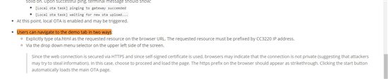

跟着里面的readme不行,网页访问不成功
您现在能走到哪一步?
是上图这里吗?
需要指出的是
Users can navigate to the demo tab in two ways这句中的 "tab" 实际是指 OTA "page": [CC3220-IP]/ota.html.
The ota.html should be programmed to devices by uniflash after it is imported with the zipped project within the local_ota example (see under <sdk-root>/examples\rtos\CC3220SF_LAUNCHXL\demos\local_ota\uniflash).
