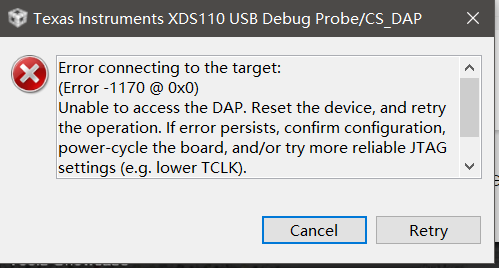

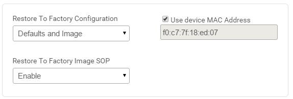

Error connecting to the target: (Error -1170 @ 0x0)
Other Parts Discussed in Thread: UNIFLASH
CCS7.3 /CC3220S-LAUNCHPAD: (Error -1170 @ 0x0) Unable to access the DAP)
(Error -1170 @ 0x0)
Unable to access the DAP. Reset the device, and retry the operation. If error persists, confirm configuration, power-cycle the board, and/or try more reliable JTAG settings (e.g. lower TCLK).

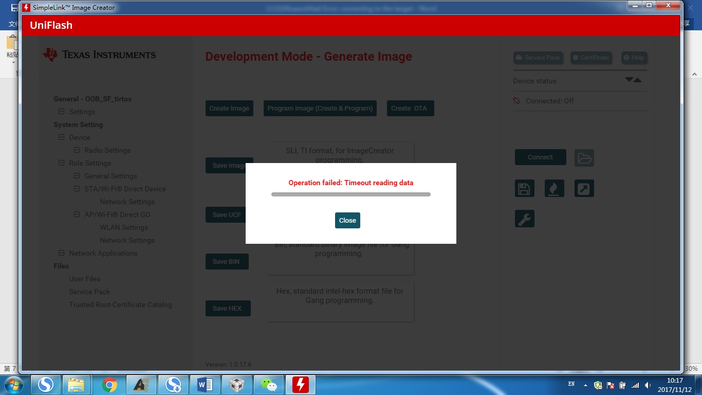

在用CCS7.3开发CC3220launchpad时,可能会遇到如上图所示的bug,导致代码不能下载。可能的原因是Image mode 设成了产品模式而非开发模式。
具体的解决办法是 用uniflash工具重新下载一遍,用开发者模式。具体的步骤我放到附件里了
