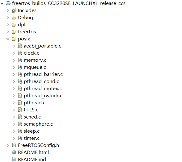

线程本质上是任务的语法包装器,看如下表述:
FreeRTOS have tasks. pthread is suggested as a wrapper to task for portability and compatability with POSIX systems and code. Anyway, FreeRTOS do not have memory seperation, virtualization and remapping on context switch between tasks, so all it's tasks are what POSIX would call threads.
