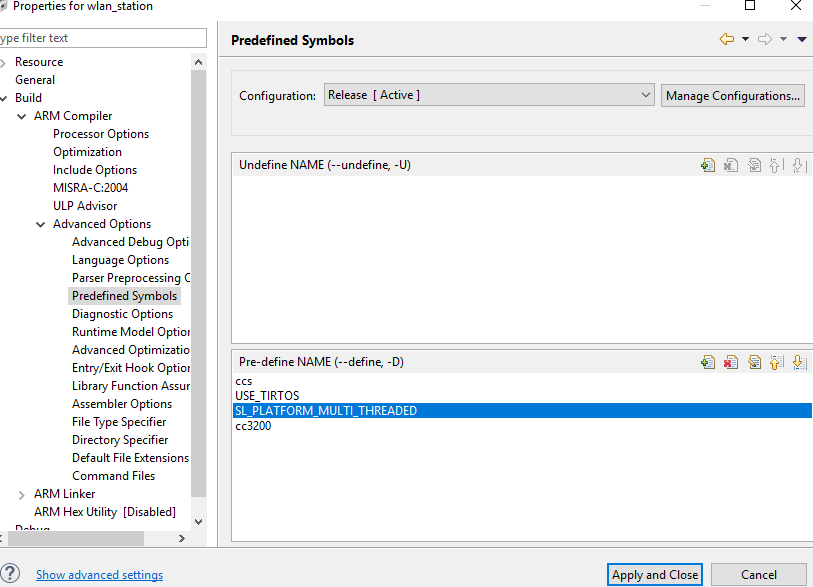

SL_PLATFORM_MULTI_THREADED 这个宏定义是系统自动打开的吗
系统处于多线程的情况下 就会打开?
看到别 的帖子说 getting_started_with_wlan_station 里面这个定义是打开的 可是 运行过程中 发现没有打开啊

The SimpleLink Wi-Fi host driver can run on multithreaded environment (OS), as well as a non-OS
environment. This step is not required if the host application is based on a non-OS environment.
To enable the multithreaded environment, the macro SL_PLATFORM_MULTI_THREADED must be
defined. For example:
#define SL_PLATFORM_MULTI_THREADED
The OS adaptation layer consists of two major objects:
• Sync objects – To allow synchronization between threads
• Locking objects – To protect access to resources from different threads
SL_PLATFORM_MULTI_THREADED 默认打开:
