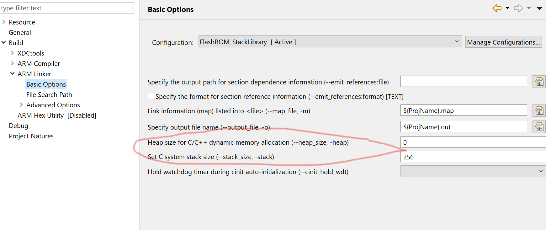

CC3200 任务堆栈溢出怎么解决
CCS里面---project右键Properties-> Build -> ARM Linker -> Basic options ,增加heap/Stack size
显示这个 中间利用SPI和中断读取AD值并发给上位机,运行完成后后程序就停了
FaultISR
<Exception frame>
xQueueGenericReceive
osi_LockObjLock
_SlDrvObjGlobalLockWaitForever
_SlDrvDataWriteOp
sl_SendTo
SendMessage
handleMsgSample
MessageHandle
ReceiveTask
prvTaskExitError
