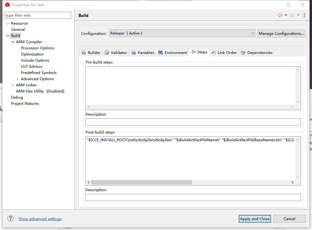

CCSV10.0.0如何生成.bin文件
按CCSv6的方法在build\steps\Post-build steps中添加了命令
"${CCE_INSTALL_ROOT}/utils/tiobj2bin/tiobj2bin" "${BuildArtifactFileName}" "${BuildArtifactFileBaseName}.bin" "${CG_TOOL_ROOT}/bin/armofd" "${CG_TOOL_ROOT}/bin/armhex" "${CCE_INSTALL_ROOT}/utils/tiobj2bin/mkhex4bin"
再build project之后没有生成.bin文件。应该怎么操作呢
  • 在build\steps\Post-build steps中添加以下命令:${CCS_INSTALL_ROOT}/utils/tiobj2bin/tiobj2bin ${BuildArtifactFileName} ${BuildArtifactFileBaseName}.bin ${CG_TOOL_ROOT}/bin/armofd ${CG_TOOL_ROOT}/bin/armhex ${CCS_INSTALL_ROOT}/utils/tiobj2bin/mkhex4bin
    然后rebuild一下,我试了可以生成bin文件
