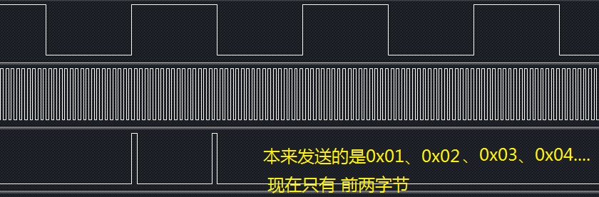

     你们好,我现在又碰到了一个问题,non-DMA 的 I2S ,发数据的时候,只能发送前两个字节,两个字节之后I2SDataPutNonBlocking的返回值总是-1,应该表示buffer总是满的,为什么会出现这种情况啊?

void I2S_Init(void)
    //512000 = 16*2*16000Khz(Num of bytes * STEREO * 16000 sampling)
    MAP_PRCMPeripheralClkEnable(PRCM_I2S,PRCM_RUN_MODE_CLK);
    MAP_PRCMPeripheralReset(PRCM_I2S);
#if 1
    MAP_PRCMI2SClockFreqSet(512000);
    MAP_I2SConfigSetExpClk(I2S_BASE, 512000, 512000, I2S_SLOT_SIZE_16|I2S_PORT_CPU);
#else
    MAP_PRCMI2SClockFreqSet(1411200);
    MAP_I2SConfigSetExpClk(I2S_BASE, 14112000, 14112000, I2S_SLOT_SIZE_16|I2S_PORT_CPU);
#endif
    MAP_I2SIntRegister(I2S_BASE, I2SIntHandler);
//    MAP_I2SIntEnable(I2S_BASE,(I2S_INT_XDATA|I2S_INT_XSTAFRM|I2S_INT_XLAST) );
    MAP_I2SIntEnable(I2S_BASE,(I2S_INT_XDATA) );
    MAP_I2SSerializerConfig(I2S_BASE, I2S_DATA_LINE_0,I2S_SER_MODE_TX, I2S_INACT_LOW_LEVEL);
//    MAP_I2SIntEnable(I2S_BASE,(I2S_INT_RDATA|I2S_INT_RSTAFRM|I2S_INT_RLAST) );
    MAP_I2SIntEnable(I2S_BASE,(I2S_INT_RDATA) );
    MAP_I2SSerializerConfig(I2S_BASE, I2S_DATA_LINE_1, I2S_SER_MODE_RX, I2S_INACT_LOW_LEVEL);
#if 0
    MAP_I2SEnable(I2S_BASE, I2S_MODE_TX_RX_SYNC);
#endif
bool I2S_test_flag = 0;
void I2S_start(void)
I2S_test_flag = 1;
void I2S_stop(void)
MAP_I2SDisable(I2S_BASE);
I2S_test_flag = 0;
