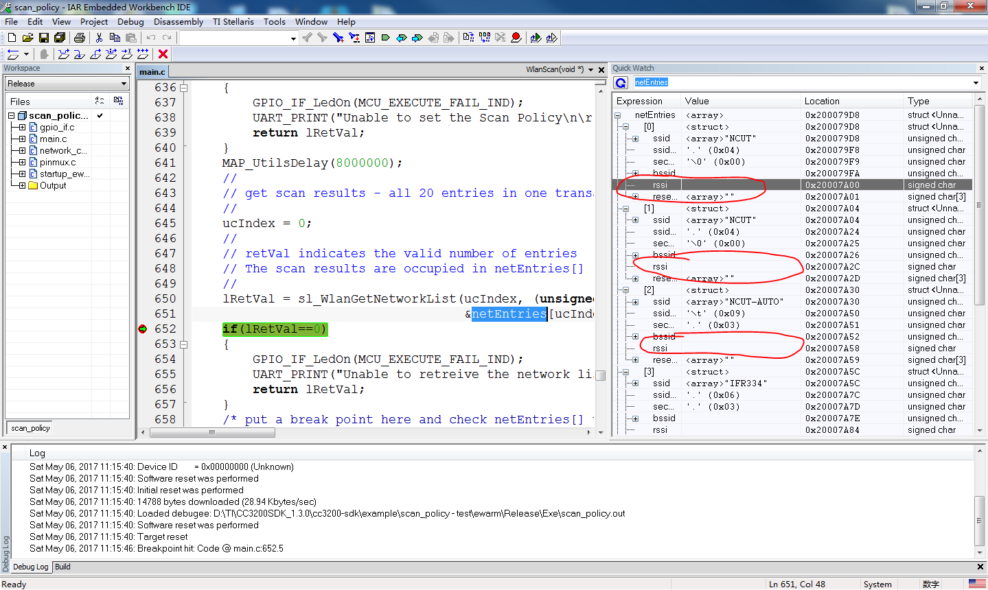

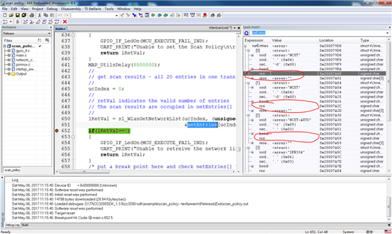

如题,请知道的高人不吝赐教,谢谢
Sl_WlanNetworkEntry_t netEntries[20]; // Wlan Network Entry
do
lRetVal = sl_WlanGetNetworkList(ucIndex,
(unsigned char)WLAN_SCAN_COUNT/4,
&netEntries[ucIndex]);
ucIndex += lRetVal;
while ((lRetVal == WLAN_SCAN_COUNT/4) && (ucIndex < WLAN_SCAN_COUNT));
可以参考一下scan_policy的例程,结构体Sl_WlanNetworkEntry_t 里面有RSSI这一项。
