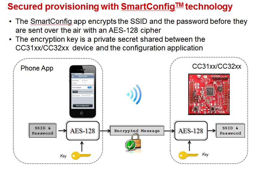

想问CC32xx Provisioning Smart Config这个例程是不是用手机app输入路由器以及板子名字的信息,让板子自动连上路由器的啊?
  • Hi Huier,
    关于smartconfig,官方的介绍说明如下:
    SmartConfig™ technology, a one-step Wi-Fi setup process that allows multiple in-home devices to connect to Wi-Fi networks quickly and efficiently. Considering applications that typically do not have a display or keyboard to enter Wi-Fi network name and password, SmartConfig technology gives end users the ability to easily connect their CC3000-based devices to an access point. Through a simple SmartConfig technology interface, consumers can use an iOS or Android smartphone/tablet or home PC using just a simple Web browser.
    具体过程可以参考下面的图示:
    主要需要用户输入的是SSID和Password, 当然双方都约定了key的话,也可以作为一个验证的信息。
    您可以自己下载操作以下,ios,Android,pc上都有相应版本:
    http://www.ti.com/tool/SmartConfig?keyMatch=smartconfig&tisearch=Search-EN-Everything#descriptionArea
