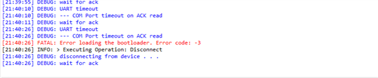

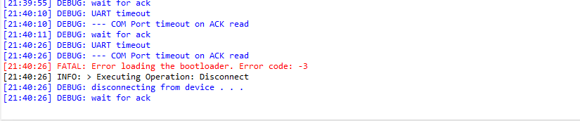

请帮我看一下 现在自己画的板子可以进行debug 调试,引出的LED灯可以进行控制亮灭,但是无法使用uniflash 下载程序,串口使用的uart0 ,sop 2 接高电平,低电平都试过,复位信号直接在lanchpad 读取,但是依旧无法下载程序,遇到瓶颈了 ,请问还有什么我没有注意到的问题么?

    [21:39:55] DEBUG: 1
    [21:39:55] DEBUG: wait for ack
    [21:40:10] DEBUG: UART timeout
    [21:40:10] DEBUG: --- COM Port timeout on ACK read
    [21:40:11] DEBUG: wait for ack
    [21:40:26] DEBUG: UART timeout
    [21:40:26] DEBUG: --- COM Port timeout on ACK read
    [21:40:26] FATAL: Error loading the bootloader. Error code: -3

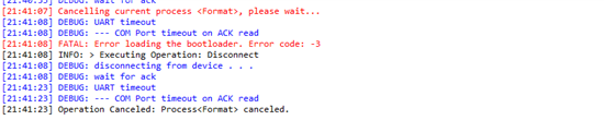

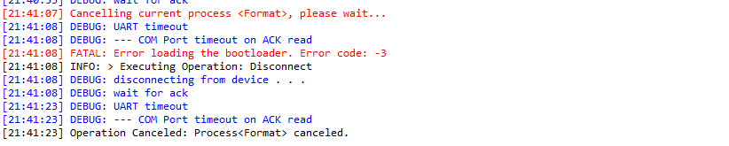

    [21:41:07] Cancelling current process <Format>, please wait...
    [21:41:08] DEBUG: UART timeout
    [21:41:08] DEBUG: --- COM Port timeout on ACK read
    [21:41:08] FATAL: Error loading the bootloader. Error code: -3
    [21:41:08] INFO: > Executing Operation: Disconnect
    [21:41:08] DEBUG: disconnecting from device . . .
    [21:41:08] DEBUG: wait for ack
    [21:41:23] DEBUG: UART timeout
    [21:41:23] DEBUG: --- COM Port timeout on ACK read
    [21:41:23] Operation Canceled: Process<Format> canceled.
