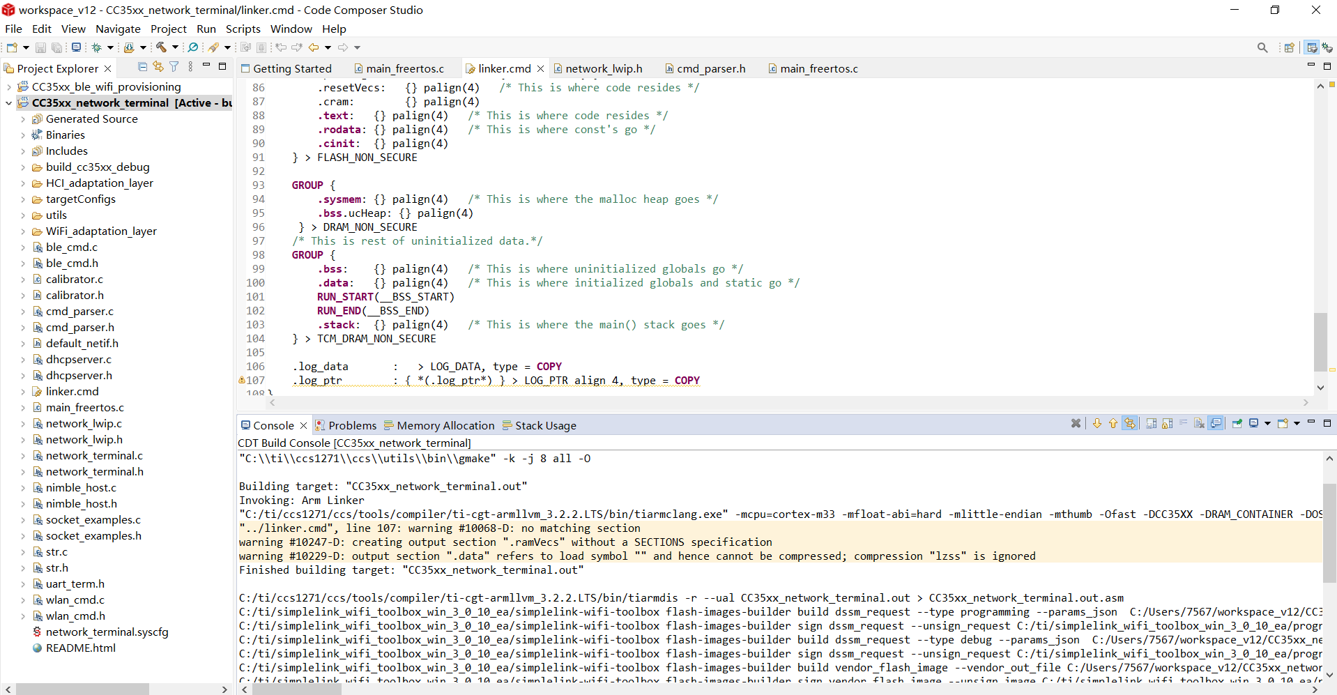

你好,
我按照Quickstart CC35XX User's Guide8.21.00.x里CCS下载和安装及设置步骤之后编译工程时出现了如下三个warning:
"../linker.cmd", line 107: warning #10068-D: no matching section;
warning #10247-D: creating output section ".ramVecs" without a SECTIONS specification;
warning #10229-D: output section ".data" refers to load symbol "" and hence cannot be compressed; compression "lzss" is ignored;
使用的CCS版本是12.7.1,simplelink_wifi_sdk_8_41_0_0_eng里的示例工程CC35xx_network_terminal
对于解决此问题的任何建议、我将不胜感激。

  • 这是linker.cmd文件:

    这是console:
    **** Build of configuration build_cc35xx_debug for project CC35xx_network_terminal ****
    "C:\\ti\\ccs1271\\ccs\\utils\\bin\\gmake" -k -j 8 all -O
    Building target: "CC35xx_network_terminal.out"
    Invoking: Arm Linker
    "C:/ti/ccs1271/ccs/tools/compiler/ti-cgt-armllvm_3.2.2.LTS/bin/tiarmclang.exe" -mcpu=cortex-m33 -mfloat-abi=hard -mlittle-endian -mthumb -Ofast -DCC35XX -DRAM_CONTAINER -DOSPREY_BUILD_MX -DCPU_M33 -DCODE_VARIANT_1 -g -Wl,-m"CC35xx_network_terminal.map" -Wl,-i"C:/ti/simplelink_wifi_sdk_8_41_0_0_eng/source" -Wl,-i"C:/Users/7567/workspace_v12/CC35xx_network_terminal/build_cc35xx_debug/syscfg" -Wl,-i"C:/ti/ccs1271/ccs/tools/compiler/ti-cgt-armllvm_3.2.2.LTS/lib" -Wl,-i"C:/ti/ccs1271/ccs/tools/compiler/ti-cgt-armllvm_3.2.2.LTS/lib" -Wl,--reread_libs -Wl,--diag_wrap=off -Wl,--display_error_number -Wl,--warn_sections -Wl,--xml_link_info="CC35xx_network_terminal_linkInfo.xml" -Wl,--rom_model -o "CC35xx_network_terminal.out" "./ble_cmd.o" "./calibrator.o" "./cmd_parser.o" "./dhcpserver.o" "./main_freertos.o" "./network_lwip.o" "./network_terminal.o" "./syscfg/ti_drivers_config.o" "./syscfg/ti_freertos_config.o" "./syscfg/ti_freertos_portable_config.o" "./nimble_host.o" "./socket_examples.o" "./str.o" "./wlan_cmd.o" "./HCI_adaptation_layer/uart_hci.o" "./WiFi_adaptation_layer/osi_dpl.o" "./WiFi_adaptation_layer/osi_filesystem.o" "./WiFi_adaptation_layer/uart_term.o" "../linker.cmd"  -Wl,-l"C:/ti/simplelink_wifi_sdk_8_41_0_0_eng/source/ti/net/ble_interface/lib/ble_interface.lib" -Wl,-l"C:/ti/simplelink_wifi_sdk_8_41_0_0_eng/source/ti/drivers/net/wifi/wifi_platform/cc35xx/lib/wifi_platform_cc35xx.lib" -Wl,-l"C:/ti/simplelink_wifi_sdk_8_41_0_0_eng/source/ti/drivers/net/wifi/wifi_host_driver/lib/cc35xx/wifi_host_driver.lib" -Wl,-l"C:/ti/simplelink_wifi_sdk_8_41_0_0_eng/source/ti/net/wifi_stack/lib/wifi_stack.lib" -Wl,-l"C:/ti/simplelink_wifi_sdk_8_41_0_0_eng/source/third_party/hostap/lib/hostapd.lib" -Wl,-l"C:/ti/simplelink_wifi_sdk_8_41_0_0_eng/source/third_party/lwip/lib/lwip.lib" -Wl,-l"C:/ti/simplelink_wifi_sdk_8_41_0_0_eng/source/third_party/mbedTLS/lib/mbedTLS.lib" -Wl,-l"C:/ti/simplelink_wifi_sdk_8_41_0_0_eng/source/third_party/nimble/lib/ble_host_nimble.lib" -Wl,-lti_utils_build_linker.cmd.genlibs -Wl,-llibc.a
