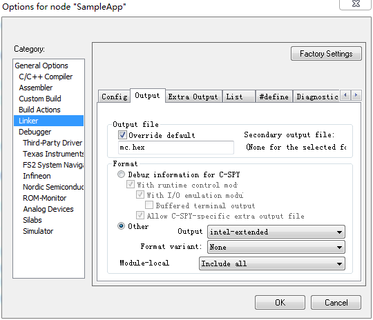

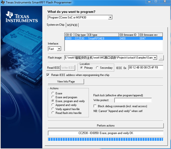

1. 在.xcl中有没有enable -M,如下;
// Include these two lines when generating a .hex file for banked code model:
-M(CODE)[(_CODEBANK_START+_FIRST_BANK_ADDR)-(_CODEBANK_END+_FIRST_BANK_ADDR)]*\
_NR_OF_BANKS+_FIRST_BANK_ADDR=0x8000

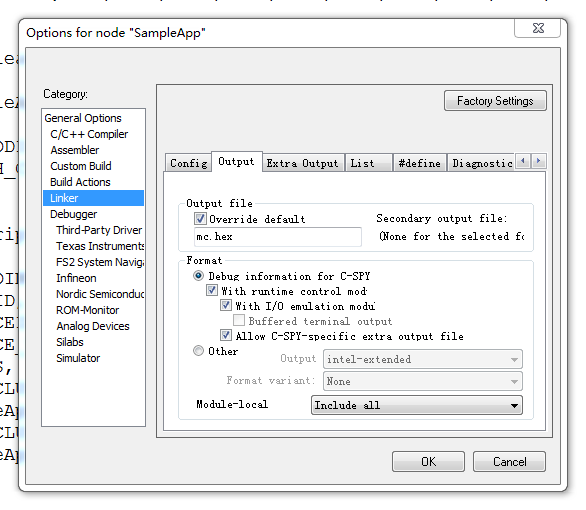

2. 尝试在Extra output里设置,而不是在output选项页
