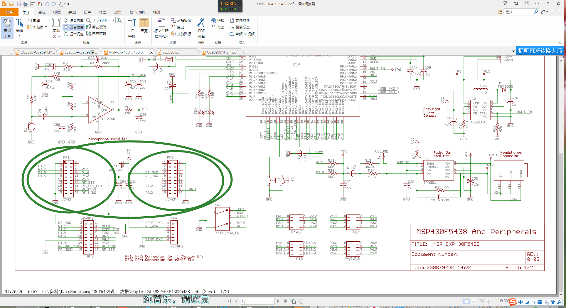

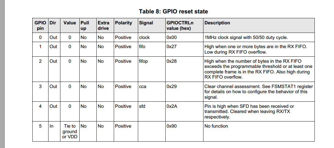

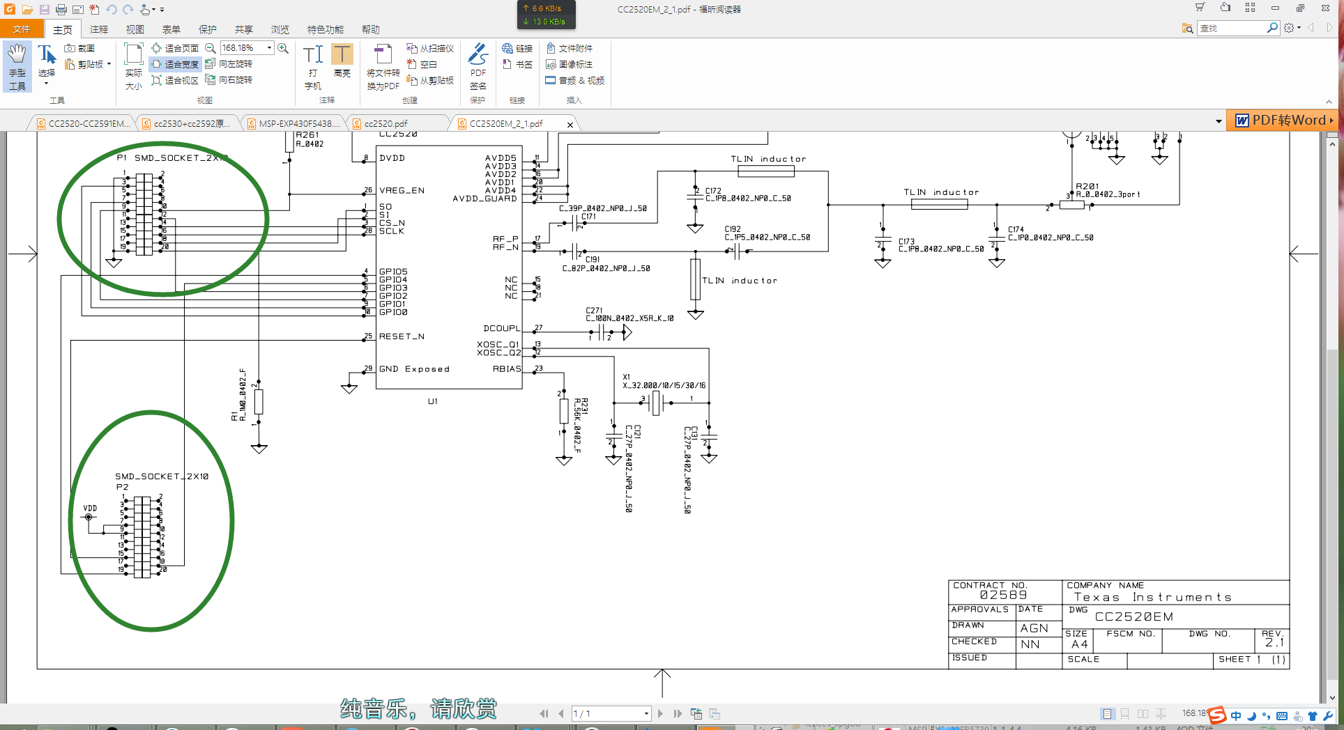

  • 请问mesh 里的 *                            TX_ACK_DONE/TX_FRM_DONE Pin / Interrupt Configuration
    #define HAL_MAC_TX_ACK_DONE_GPIO_BIT            4
    #define HAL_MAC_READ_TX_ACK_DONE_PIN()          (P1IN & BV(HAL_MAC_TX_ACK_DONE_GPIO_BIT))
    #define HAL_MAC_CONFIG_TX_ACK_DONE_PIN_AS_INPUT()   st( P1DIR &= ~BV(HAL_MAC_TX_ACK_DONE_GPIO_BIT); )
    #define HAL_MAC_CONFIG_TX_ACK_DONE_PIN_AS_OUTPUT()  st( P1DIR |=  BV(HAL_MAC_TX_ACK_DONE_GPIO_BIT); )
     *                                  TRIGGER Pin Configuration
    #define HAL_MAC_TRIGGER_GPIO_BIT                2
    #define HAL_MAC_CONFIG_TRIGGER_PIN_AS_OUTPUT()  st( P8DIR |=  BV(HAL_MAC_TRIGGER_GPIO_BIT); \
                                                        P8SEL |=  BV(HAL_MAC_TRIGGER_GPIO_BIT);)
    #define HAL_MAC_CONFIG_TRIGGER_PIN_AS_INTPUT()  st( P8DIR &= ~BV(HAL_MAC_TRIGGER_GPIO_BIT); \
                                                        P8SEL &= ~BV(HAL_MAC_TRIGGER_GPIO_BIT);)
    这两个脚在cc2520里找不到呀。在cc2520手册只看到了CCA  FIFO FIFOP SFD.GPIO0 是时钟输出。GPIO5链接地或电源。另外的TRIGGER和TX_ACK找不到
