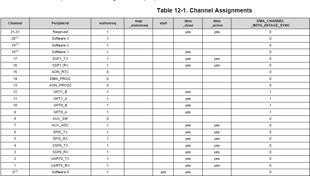

cc26xx udma能实现ram到flash的传输吗?
datasheet中介绍如下,似乎可以是ram到peripherals,但flash不行,不知理解是否正确?
The μDMA controller can perform transfers between memory and peripherals. The controller has dedicated channels for each supported on-chip module, and can be programmed to automatically perform transfers between peripherals and memory as the peripheral is ready to transfer more data.
