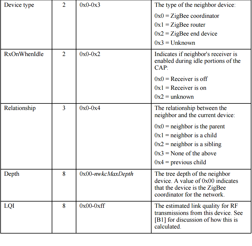

紧急求助:mtZdoMgmtLqiRspCb 返回信息中DevTyp_RxOnWhenIdle_Relat = 0x15 这个字段表示什么含义?
mtZdoMgmtLqiRspCb
SrcAddr: 0x0000
Status: 0x00
NeighborTableEntries: 0x02
StartIndex: 0x00
NeighborLqiListCount: 0x02
mtZdoNeighborLqiListItem[0]:
        ExtendedPanID: 0x00124B0003D36252
        ExtendedAddress: 0x00124B00092D7BB8
        NetworkAddress: 0x06BC
        DevTyp_RxOnWhenIdle_Relat: 0x15
        PermitJoining: 0x02
        Depth: 0x01
        LQI: 0xAA
mtZdoNeighborLqiListItem[1]:
        ExtendedAddress: 0x00124B0010012F51
        NetworkAddress: 0xEF2F
        PermitJoining: 0x02
        Depth: 0x01
        LQI: 0xAA
