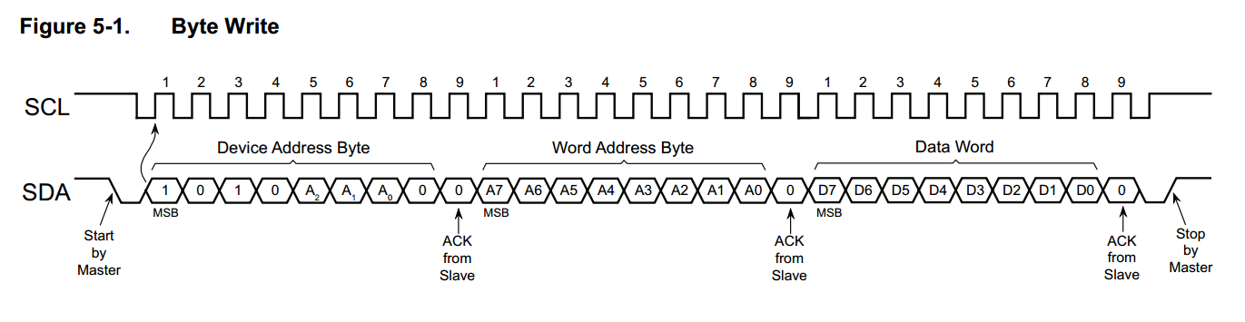

1、是不是CC2538 i2c有bug,TI也只给了个头文件,示例程序都不提供,调试了几天,I2C通讯一直有问题,就想给7-bit的0x50从机发送两个字节的数据,0x15,0x26
    //set slave address(Device Address)
    I2CMasterSlaveAddrSet(slaveAddr,false);       //false:write
    //set sub address(Word Address)
    I2CMasterDataPut(subAddr);
    I2CMasterControl(I2C_MASTER_CMD_BURST_SEND_START);            //star+run
    // Wait until master module is done transferring.
    while(I2CMasterBusy()){}
    // Place the data to be sent in the data register
    I2CMasterDataPut(data);
    I2CMasterControl(I2C_MASTER_CMD_BURST_SEND_CONT);
    I2CMasterControl(I2C_MASTER_CMD_BURST_SEND_ERROR_STOP);
2、这是从器件要求的时序,发送完slave address以后不能直接stop的,要接着发送word address(sub address),然后是data,最后才能stop。
