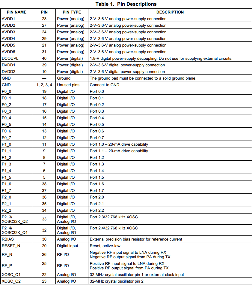

画PCB要找串口映射脚,datasheet里并没有描述
您可以查看 http://www.ti.com/lit/ug/swru191f/swru191f.pdf
Table 7-1. Peripheral I/O Pin Mapping
