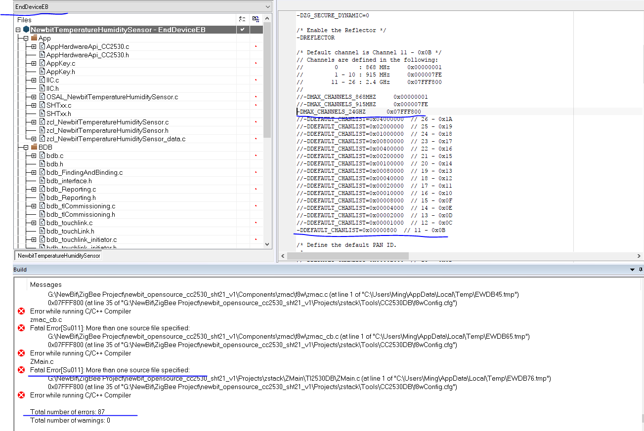

错误提示:
Fatal Error[Su011]: More than one source file specified:

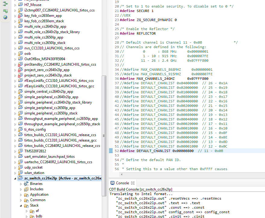

I think ZigBee 3.0 you should config channel as the following Z-stack document,
9.1 Configuring channel
Every Z3.0 device has a primary channel mask configuration (BDB_DEFAULT_PRIMARY_CHANNEL_SET) and a
secondary channel mask configuration (BDB_DEFAULT_SECONDARY_CHANNEL_SET).
