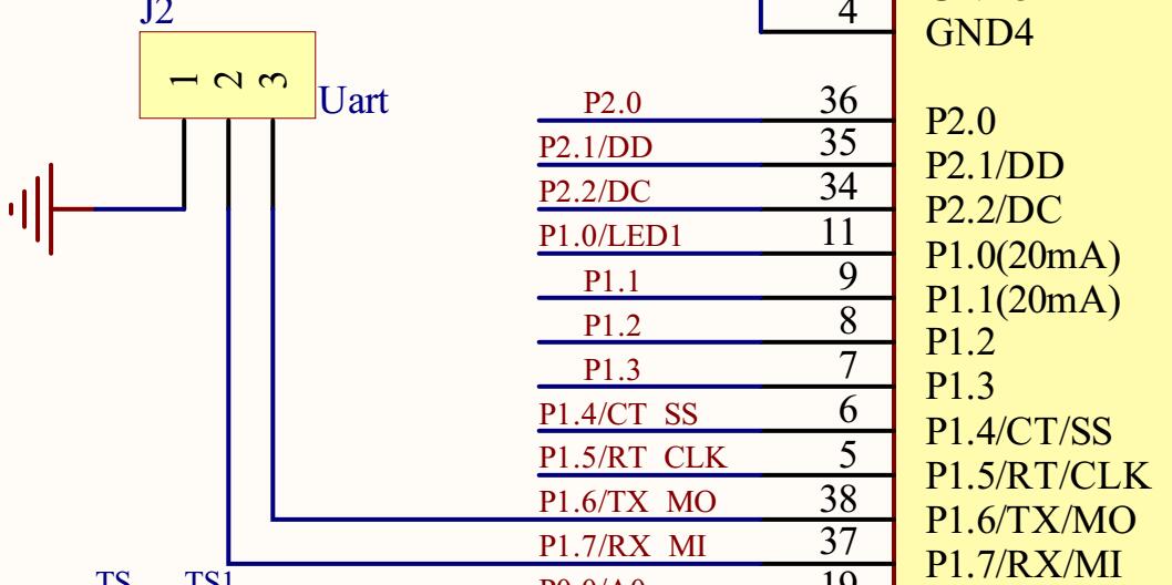

cc2530串口1调不通
Other Parts Discussed in Thread: CC2530
cc2530裸机编程  串口1调不通
使用p1.6 p1.7
请教下是怎么回事?是配置问题还是其他问题呢?
配置如下 :
PERCFG |= 0x20;
P1SEL |= 0xb0;
P2SEL |= 0x40;
P2SEL &= ~0x20;
P1DIR |= 0x40;
U1CSR |= 0x80;
U1GCR |= 11;
U1BAUD |= 216;
UTX1IF = 0;
