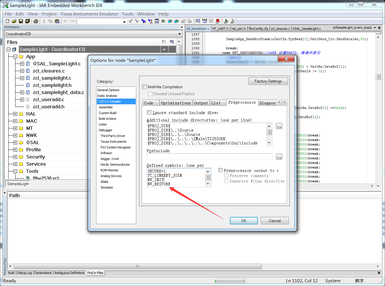

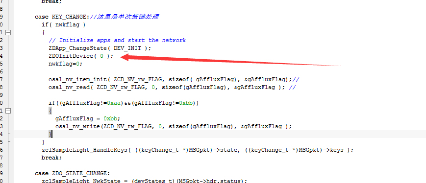

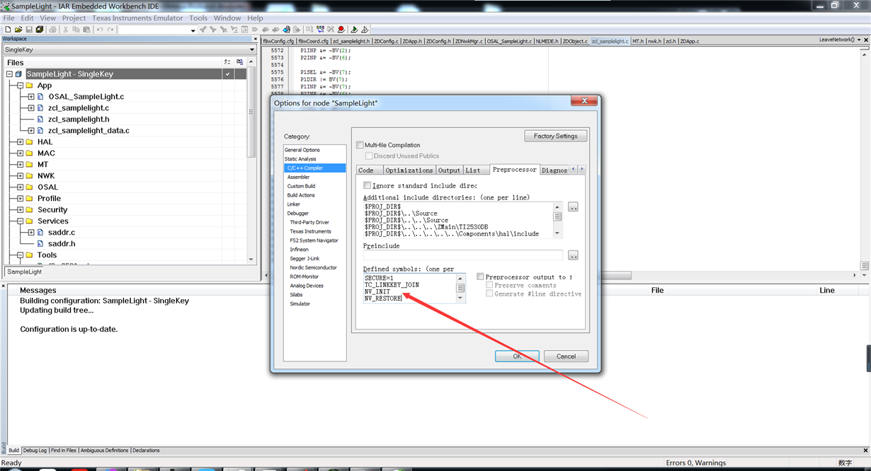

终端设备开启NV无法重入网
1.协议栈 zstakc1.2.2a
终端设备设置datarequest间隔 1s
编译:
POWER_SAVING
NWK_AUTO_POLL
HOLD_AUTO_START
xZTOOL_P1
xMT_TASK
xMT_APP_FUNC
xMT_SYS_FUNC
xMT_ZDO_FUNC
xLCD_SUPPORTED=DEBUG
MULTICAST_ENABLED=FALSE
ZCL_READ
ZCL_WRITE
ZCL_REPORT
xZCL_EZMODE
ZCL_BASIC
ZCL_IDENTIFY
ZCL_ON_OFF
ZCL_SCENES
ZCL_GROUPS
xZCL_LEVEL_CTRL
ZCL_DIAGNOSTIC
FEATURE_SYSTEM_STATS
WDT_IN_PM1
KEY
THREE_KEY
MANAGED_SCAN
xHAL_LCD
xHAL_LED
xBLINK_LEDS
抓包短地址为:0x0AD5的设备,无复位,自己rejoin到了其他网络中
