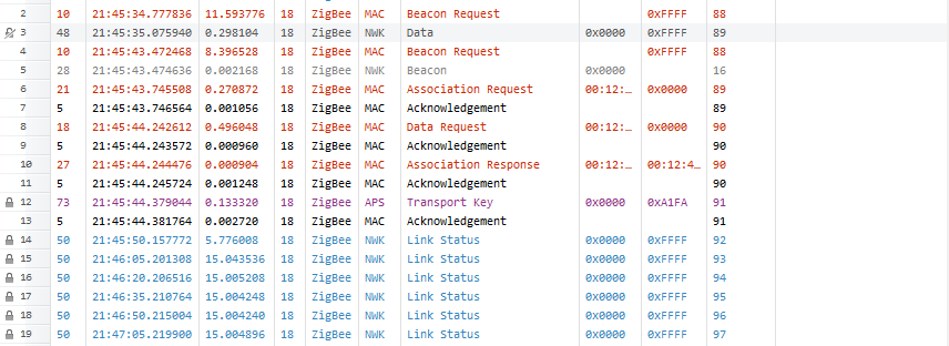

zigee3.0.1协议栈基于genericAPP的router及enddevice通过bdb_startcommisson(BDB_COMMISSIONING_MODE_NWK_STEERING)无法入网
测试了samplelight和sampleswitch同样不行,抓包如图:
