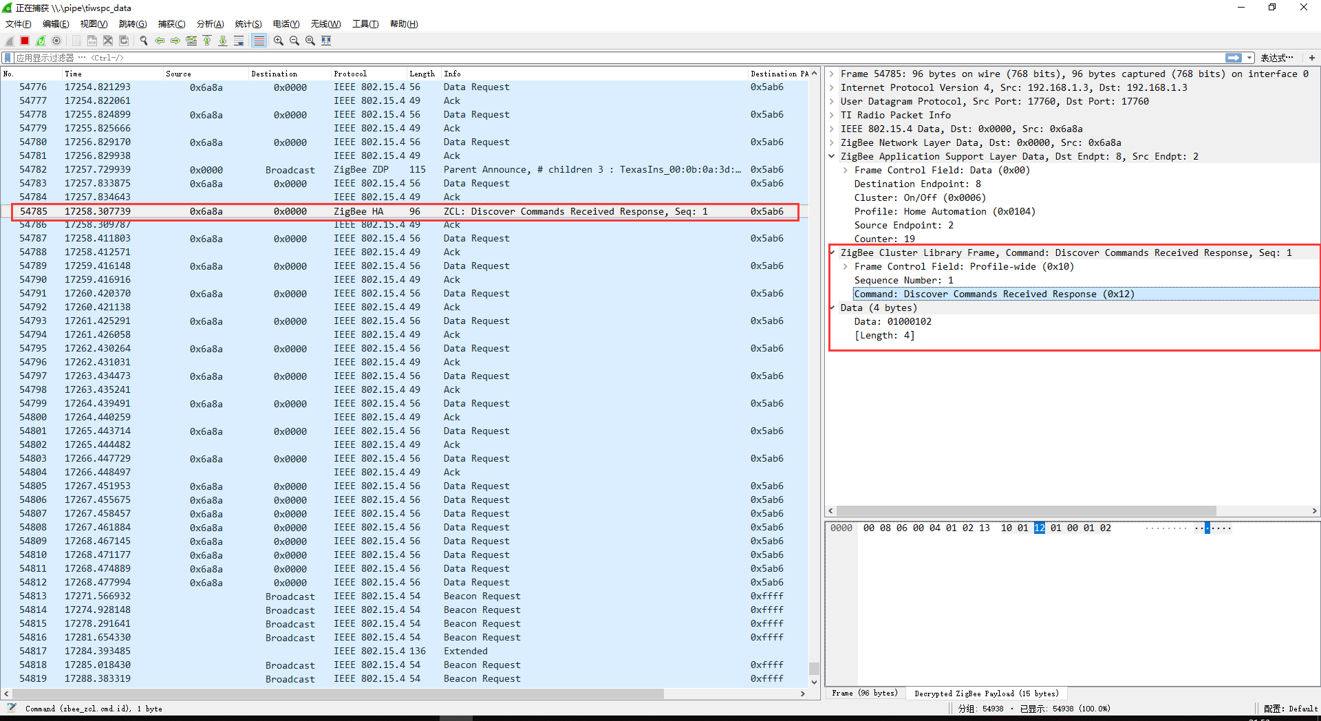

1、问题描述
(1)我用终端主动发送 “Discover Commands Received Response” 命令给协调器。
 (2)协调器在应用层的 ZCL_CMD_DISCOVER_CMDS_RECEIVED_RSP 中处理此消息。
  • static uint8 zclGenericApp_ProcessInDiscCmdsRspCmd( zclIncomingMsg_t *pInMsg )
  •     zclDiscoverCmdsCmdRsp_t *discoverRspCmd;
  •     uint8 i;
  •     discoverRspCmd = (zclDiscoverCmdsCmdRsp_t *)pInMsg->attrCmd;
  •     for ( i = 0; i < discoverRspCmd->numCmd; i++ )
  •         // Device is notified of the result of its attribute discovery command.
  •     return ( TRUE );
(3)发现获取到的命令ID与终端发送过来的命令ID不同。
2、我更改 zclDiscoverCmdsCmdRsp_t 结构体后就可以了。

  • zclProcessInDiscCmd:
      if ( i != 0 )
        for ( j = 0, cmdID = pDiscoverCmd->startCmdID; j < i; j++, cmdID++ )
          if ( !zclFindNextCmdRec( pInMsg->msg->endPoint, pInMsg->msg->clusterId, pInMsg->hdr.commandID, pInMsg->hdr.fc.direction, &cmdID, &cmdRec ) )
            break; // Attribute not supported
          cmdRsp.pCmdID[j] = cmdRec.cmdID;
    当用zcl_SendDiscoverCmdsRspCmd 回复里面:
        uint8 *pBuf = pCmdBuf;
        // Load the buffer - serially
        *pBuf++ = pDiscoverRspCmd->discComplete;
        for ( i = 0; i < pDiscoverRspCmd->numCmd; i++ )
          *pBuf++ = pDiscoverRspCmd->pCmdID[i];
    在zclParseInDiscCmdsRspCmd 处理也是这么拿出来的.
    if ( pDiscoverRspCmd != NULL )
    uint8 i;
    pDiscoverRspCmd->discComplete = *pBuf++;
    pDiscoverRspCmd->numCmd = numCmds;
    for ( i = 0; i < numCmds; i++ )
    pDiscoverRspCmd->pCmdID[i] = *pBuf++;
    应该没有什么问题吧
  • 好像是 zclProcessInDiscCmd 命令处理错误的问题,zclParseInDiscCmdsRspCmd 解析出来的 cmd id 还是正确的,你可以用原版的协议栈来测试一下。
