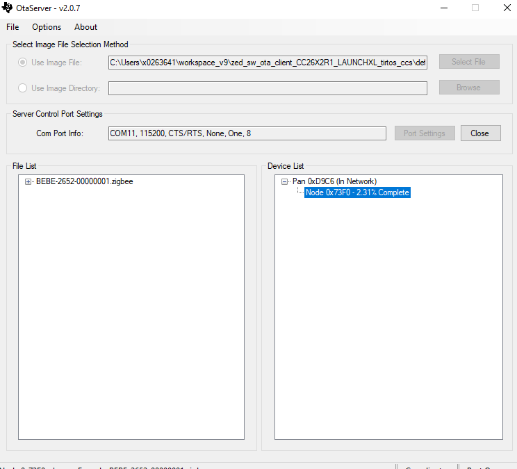

zed_sw_ota_client 不能OTA升级,谁有LaunchPad 2652R帮忙测试一下
simplelink_cc13x2_26x2_sdk_3_10_00_53版本,以zed_sw_ota_client 模板IAR 8.32.2打开保存后编译的固件,做了如下三处改动,附件是.hex和.bin文件,默认的bim off-chip Release_unsecure选项编译,请帮忙测试一下能否进行OTA升级?

3、在zclSampleSw_Init结尾增加steering操作,无需摁按键,上电直接入网
#ifdef PER_TEST
  PERTest_init(appSemHandle, appServiceTaskId, SAMPLESW_ENDPOINT );
#endif
  zstack_bdbStartCommissioningReq_t zstack_bdbStartCommissioningReq;
  zstack_bdbStartCommissioningReq.commissioning_mode = BDB_COMMISSIONING_MODE_NWK_STEERING;
  Zstackapi_bdbStartCommissioningReq(appServiceTaskId,&zstack_bdbStartCommissioningReq);
