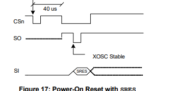

在cc2500的文档中给出了手动复位的顺序,
1、Set SCLK=1 and SI=0, to avoid potential problems with pin control mode (see Section 11.3 on page 26).
2、Strobe CSn low / high.
3、Hold CSn high for at least 40 μs relative to pulling CSn low
4、Pull CSn low and wait for SO to go low(CHIP_RDYn).
5、 Issue the SRES strobe on the SI line.
6、 When SO goes low again, reset is
complete and the chip is in the IDLE state.

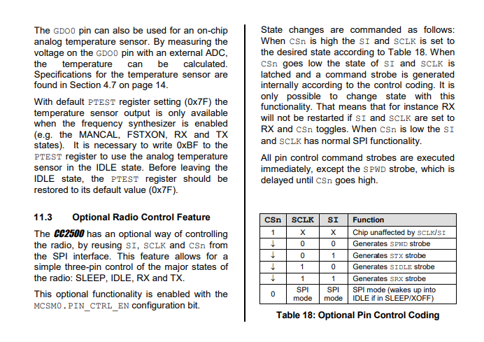

我想咨询一下SCLK = 1和SI=0在什么时候可以改变。SPI在空闲状态下是SCLK = 0,所以在发送SRES时候会出现一个下降沿,我在时候时候设置SCLK = 0比较合适。
