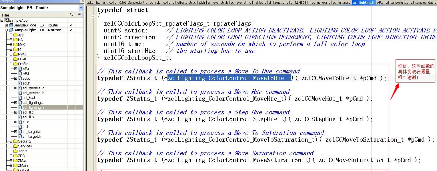

   在ZLL工程profile文件夹中,有一个文件zcl_lighting.h
   请问这个文件中类似于zclLighting_ColorControl_MoveToHue_t 这些typedefpg定义函数指针的具体实现是在哪里呀?
   以下是zcl_lighting.h的部份代码:
...//省略
// This callback is called to process a Move To Hue command
typedef ZStatus_t (*zclLighting_ColorControl_MoveToHue_t)( zclCCMoveToHue_t *pCmd );
// This callback is called to process a Move Hue command
typedef ZStatus_t (*zclLighting_ColorControl_MoveHue_t)( zclCCMoveHue_t *pCmd );
// This callback is called to process a Step Hue command
typedef ZStatus_t (*zclLighting_ColorControl_StepHue_t)( zclCCStepHue_t *pCmd );
// This callback is called to process a Move To Saturation command
typedef ZStatus_t (*zclLighting_ColorControl_MoveToSaturation_t)( zclCCMoveToSaturation_t *pCmd );
// This callback is called to process a Move Saturation command
typedef ZStatus_t (*zclLighting_ColorControl_MoveSaturation_t)( zclCCMoveSaturation_t *pCmd );
// This callback is called to process a Step Saturation command
typedef ZStatus_t (*zclLighting_ColorControl_StepSaturation_t)( zclCCStepSaturation_t *pCmd );
....//省略

  • 这里只是一个函数指针的定义而已,你可以把他理解为函数名
    http://blog.csdn.net/qll125596718/article/details/6891881
  • 你好!
       感谢你的回复,谢谢!
       我也明白这个typedef的用法,知道这个的意思。我现在想知道这些 函数指针 的具体实现是在哪里? 还是自己来写实现?
  • 只是一个类型的定义啊~ 实现么就是对应注册的函数 zclLighting_RegisterCmdCallbacks( SAMPLELIGHT_ENDPOINT, &zllSampleLight_LightingCmdCBs );
    你可以看下 zllSampleLight_LightingCmdCBs
