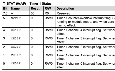

关于ZStack-CC2530-2.3.0-1.4.0中TIMER1的中断函数问题
进入中断后,调用halProcessTimer1()
void halProcessTimer1 (void)
  if (halTimerRecord[halTimerRemap(HAL_TIMER_3)].channelMode == HAL_TIMER_CH_MODE_OUTPUT_COMPARE)
    if (T1CTL & T1CTL_CH0IF)
      T1CTL &= ~(T1CTL_CH0IF);
      halTimerSendCallBack (HAL_TIMER_3, HAL_TIMER_CHANNEL_A, HAL_TIMER_CH_MODE_OUTPUT_COMPARE);
    if (T1CTL & T1CTL_CH1IF)
      T1CTL &= ~(T1CTL_CH1IF);
      halTimerSendCallBack (HAL_TIMER_3, HAL_TIMER_CHANNEL_B, HAL_TIMER_CH_MODE_OUTPUT_COMPARE);
    if (T1CTL & T1CTL_CH2IF)
      T1CTL &= ~(T1CTL_CH2IF);
      halTimerSendCallBack (HAL_TIMER_3, HAL_TIMER_CHANNEL_C, HAL_TIMER_CH_MODE_OUTPUT_COMPARE);
  else if (halTimerRecord[halTimerRemap(HAL_TIMER_3)].channelMode == HAL_TIMER_CH_MODE_OVERFLOW)
    if (T1CTL & T1CTL_OVFIF)
      T1CTL &= ~(T1CTL_OVFIF);
      halTimerSendCallBack (HAL_TIMER_3, HAL_TIMER_CHANNEL_SINGLE, HAL_TIMER_CH_MODE_OVERFLOW);
这里判断中断通道,T1CTL & T1CTL_CH0IF
我看了下数据手册
中断通道flag不是在这里的吗
