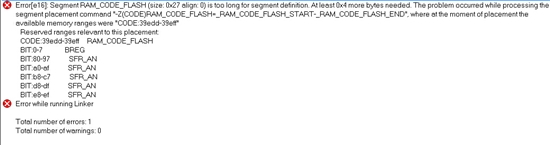

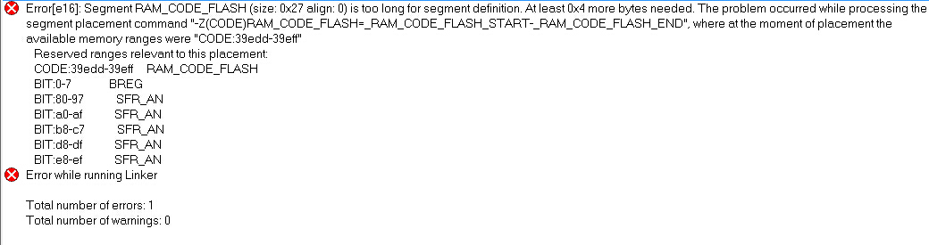

试一下链接内的方法 http://supp.iar.com/Support/?Note=95811
谢谢,搞定了,原来是版本兼容问题,V8.20 or older and in V8.30是不能自动全部兼容的。但这里所说的 .xcl文件,在哪里找出来呢:
Solution:
The .xcl file in your project probably comes from EW8051 V8.20 or older and it contains:
-Z(DATA)VREG+_NR_OF_VIRTUAL_REGISTERS=08-7F
Make a new copy of the file if needed and change that line to:
-Z(DATA)VREG=08-7F
